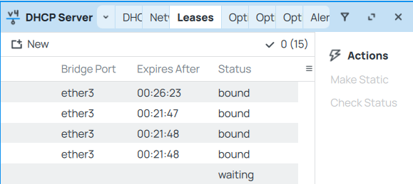

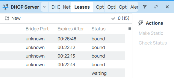

The first time you open the DHCP Server / Leases window, the Bridge Port displays the value ā€œunknownā€. After switching to another tab and back or reopening the window, the correct value is displayed.

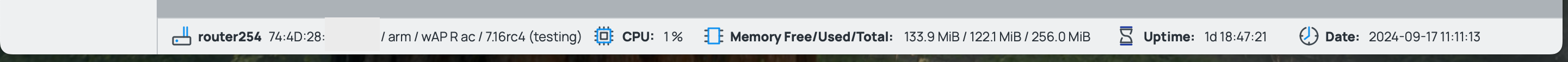

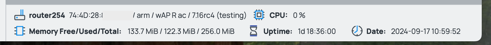

  • Ability to disable labels, like ā€œCPUā€ or ā€œMemory (Free/Used/Total)ā€, in the ā€œResource panelā€ aka status bar. i.e. have some ā€œicons onlyā€ option in settings for status/ā€œresource panelā€. Currently, it often wraps the labels, which looks weird and wastes space when CPU etc are pretty obvious without any labels:
    It takes a VERY big window (> ~1400px wide) to get all on one-line:
