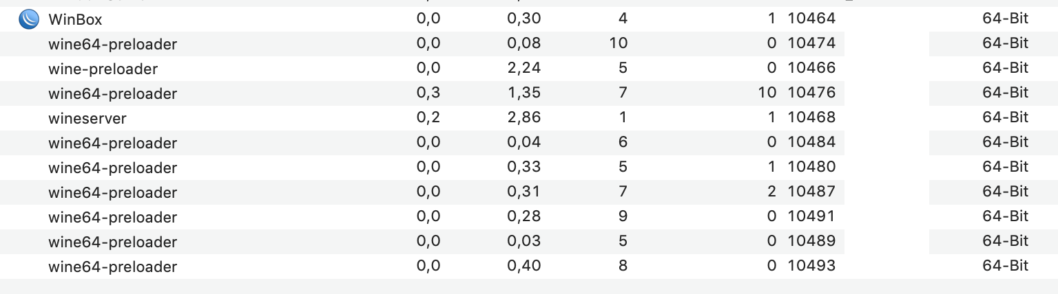

Maybe I am too dumb but the latest Google Earth Pro seems to be 64bit and I am running Wine 4.0 stable on MacOS 10.14.6 and if I start winbox.exe with “wine64” I get the following in Activity Monitor:
So, that would not be enough in 10.15 ?

No, when you run it with wine64 you run the wine process itself in 64-bit, but it can still run 32-bit code from the Windows application you launched when run that way under Mojave if i’m not mistaken.
Under Catalina you need both the Wine process to be 64-bit (which is solved with wine64), and the Windows application itself too, which is the problem with Winbox but works well with applications that is actually fully 64-bit. I tried it with a 64-bit build of Notepad++ for example, and that works as expected under Wine on Catalina as long as I launch it with the wine64 command.
