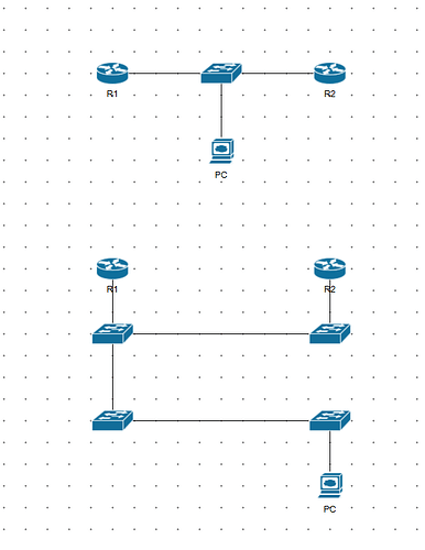

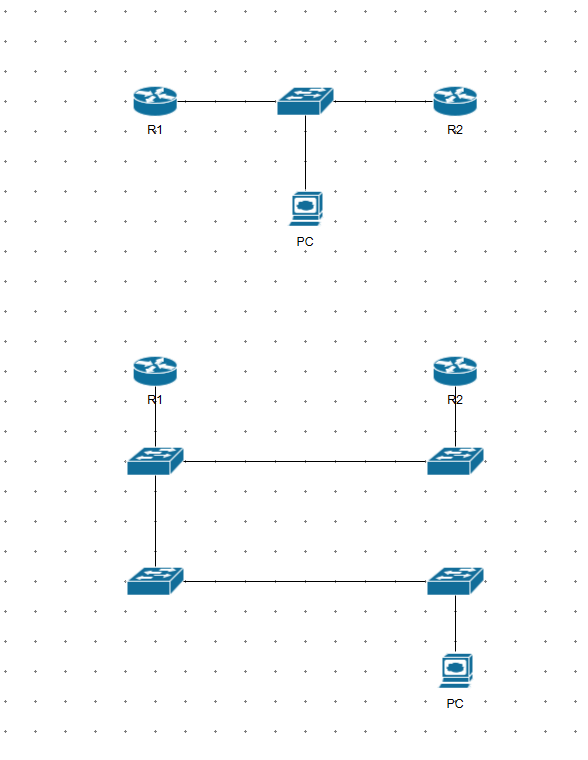

What's the simplest reproducer given two routers?
What you have described in words isn't complete.
Are you above your own posting rules? I see no configs or diagram :thinking:
Not even a mention of what routers are involved (is the hex being used just as a switch, or is it one of the routers?)
The following two "logical" configs should behave the same (for a vlan configured on all devices)
