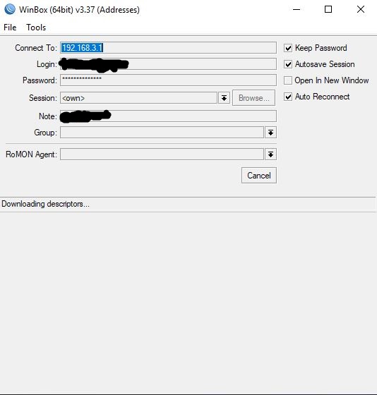

The router logs show me logging in but winbox does not load just says Downloading descriptors and just sits there and does not move.

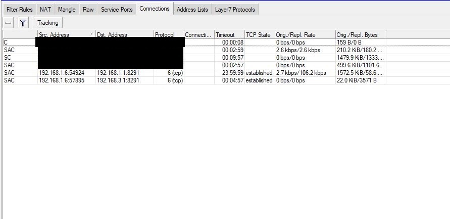

Here is the remote site logs. Showing that I login.

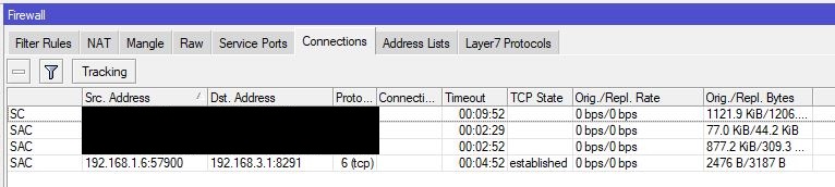

Here is the Connections to HQ.
Here is what winbox looks like when trying to connect.
