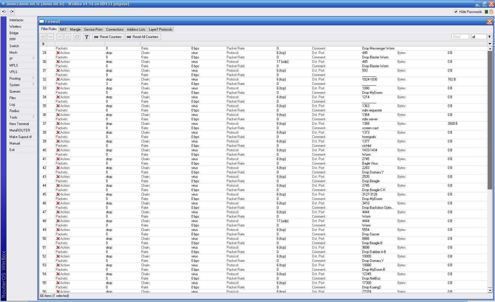

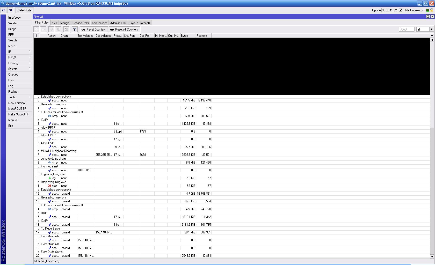

I found two bugs in Winbox, easy to reproduce.
Run Winbox, open Firewall window, Filter Rules tab.
Right click for popup menu, mark ‘Show Categories’,
next mark ‘Detail Mode’, next mark ‘Inline Comments’.
Scroll vertical scrollbar down and bug no. 1 appear.
Latest rules are not visible.
Next unmark ‘Inline Comments’, next unmark ‘Detail Mode’,
next unmark ‘Show Categories’ and scroll vertical scrollbar up.
Second bug, big black rectangle at the top of list.
Tested on MT demo routers :smiley: , as you can see ROS 4.16 and 5.0rc8 is affected.
Regards, Grzegorz.

I just tested this on following configurations:
WinXP SP3, Winbox 2.2.18
MS Server 2003 R2, Winbox 2.2.17
Win7 Home Premium, Winbox 2.2.16
At the momement I’m not able to test on Linux platform.
These bugs appear every time, just mark/unmark and scroll
down/up in order described in my first post.
Regards, Grzegorz.

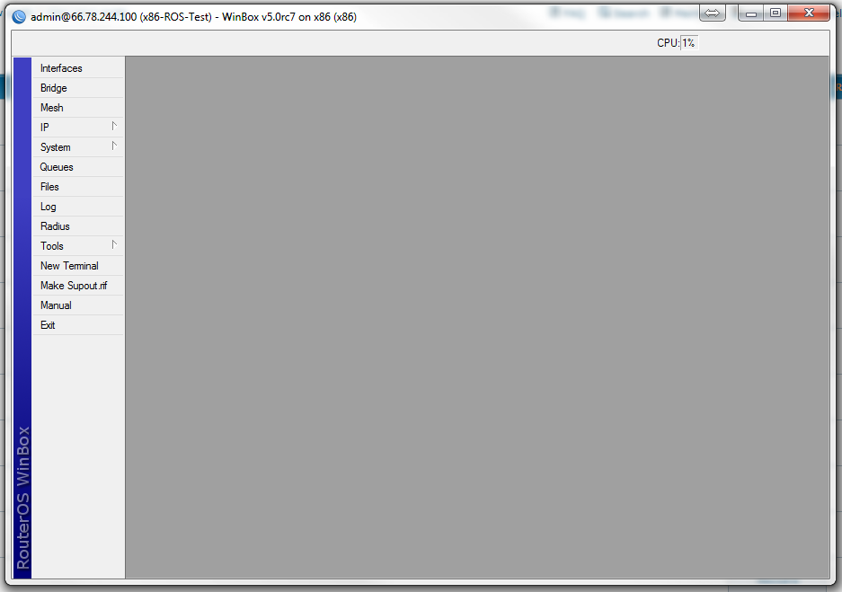

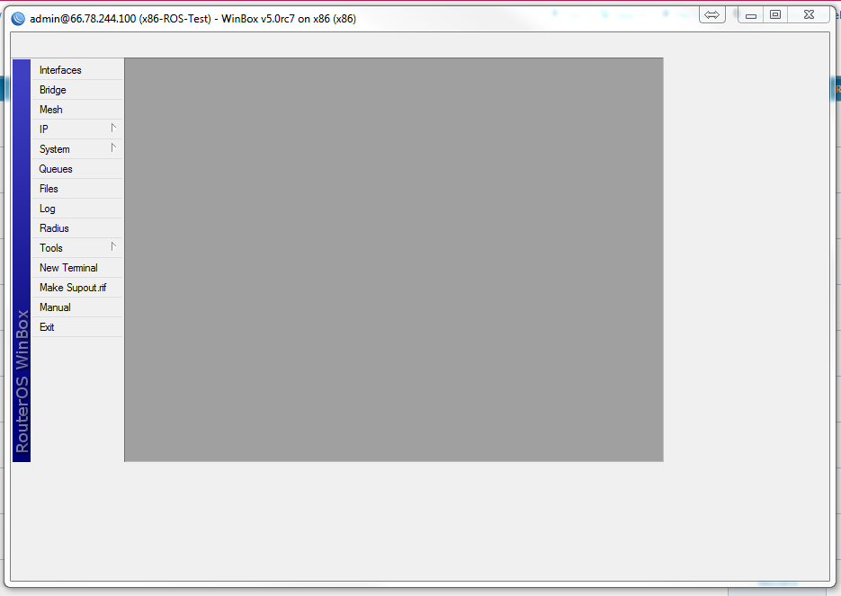

Not entirely sure when this started, but that’s a view of a 5.0rc7 accessed via Winbox. When you start Winbox it looks normal. You make the window slightly bigger, that isn’t reflected and a dead area to the right and bottom appears. You add a CPU, memory, or uptime gauge and the window finally resizes. The gauge never sits flush to the right hand side anymore.
Windows 7 64bit as a platform.
Same problem on Window 7 32-bit but only on some routers
We also have Win7 64Bit here, but no such problems. Hmmm …
This is definitely a video card driver issue… I updated the nVidia drivers and the problem vanished (this was a while ago).

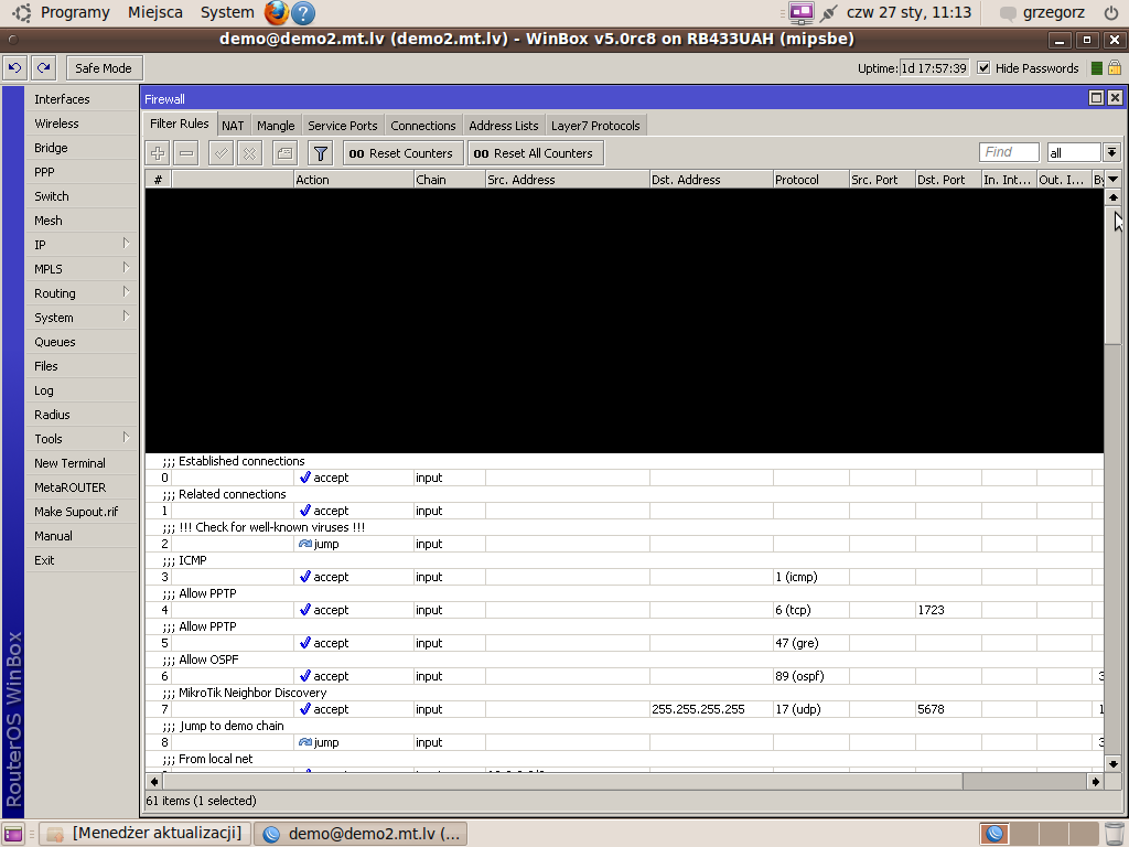

@Normis
Wine 1.2.2, Winbox 2.2.15, Ubuntu 10.04 Desktop
Regards, Grzegorz.
Had the same issue with WinBox running latest ROS 5.5 & 5.6.
Guess what was the root cause? It was the TeamViewer application’s feature “QuickConnect”. Once I disabled it - the issue went away.
I guess this might help to someone.
linux users that have black screens, you can check if you have compositioning enabled and how much RAM your video device has, or how much it has assigned. Try to increase the size. As my experience goes - with 256MB i could open 8 to 9 applications when i started to get black areas. getting graphic card with larger memory solved problem.
