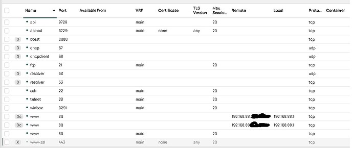

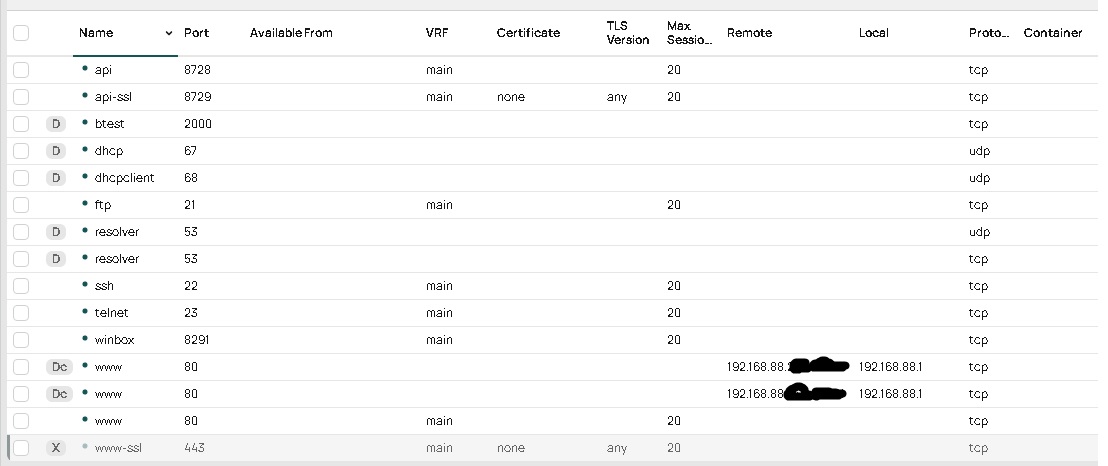

Maybe it will help.
No, can't see in Neighbors.
Wait a minute ...
And how did you make that screenshot ?
You accessed the device then ? You used web access ?

Ye,it is web access.but winbox has a better and faster user interface.always want to configure the router with it.
