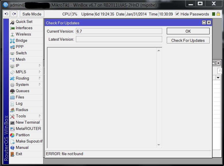

Winbox Check for Updates error.
Since 30/01/2014 I have such error when trying “Check for Updates” in winbox: “Error: file not found”
Tested on different hardware platforms, ISPs. Even devices out of the box with minimal configurations got this error.
Anyone else have this problem?
Please try again now
6.8 was withdrawn. You can check it on the download page
Wait for 6.9 :slight_smile:
Now its ok.
Upgraded one router to 6.8. Still working. Any problems may happen? Maybe better downgrade to 6.7?
no. the only issue is with RouterBOOT firmware upgrade on some older RouterBOARD models.
