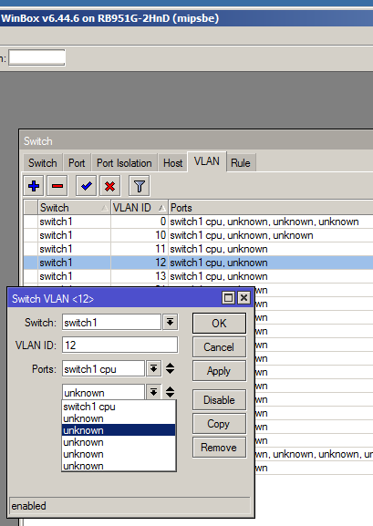

I’ve just had an instance of something similar…
This was on a 951G-2HnD running 6.44.6 (long-term) and Winbox 3.20.
The VLAN tab showed “unknown” for all the ports apart from switch1-cpu.
When I attempted to Copy an entry (vlan 12 to vlan 13) it got the port wrong, as this export shows:
/interface ethernet switch vlan
add independent-learning=yes ports=switch1-cpu,ether2 switch=switch1 vlan-id=12
add independent-learning=yes ports=switch1-cpu,ether1 switch=switch1 vlan-id=13
so it’s not just cosmetic, as “ether1” should be “ether2” for vlan 13.

sid5632, I did not quite catch how did you repeat yours. Can you share some screenshots and provide “/interface export”?
It’s a bit intermittent (sometimes it shows the correct names, sometimes it doesn’t), but I managed to reproduce it:
