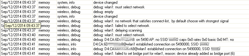

What say the log by wireless?
Pls

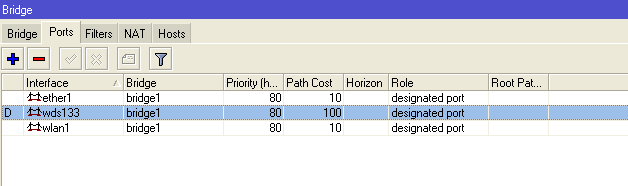

Have you wlan1 connect with pptp ore something like that.
It looks that you have the wlan interface in a bridge twice

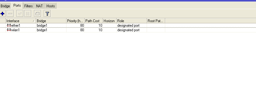

The WDS number change +1 every reconnect
Try with remove wlan1 from bridge please
From AP or ST?
Tried. The connection was lost.
