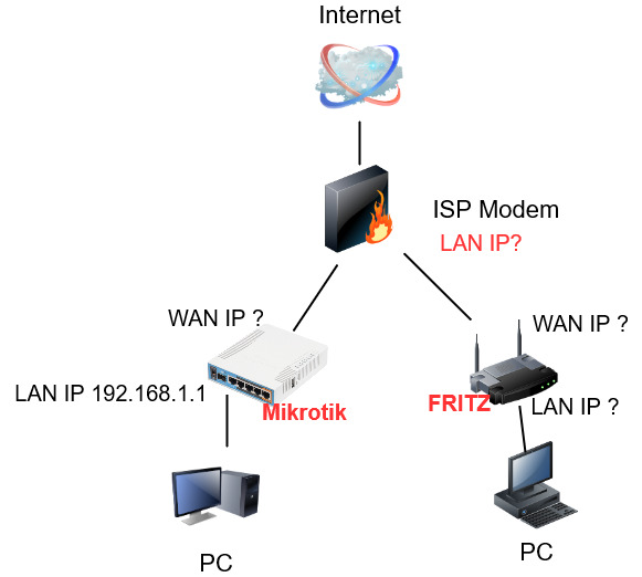

Make a drawing please indicating what is where.
Suggestion: one picture is sometimes worth more than thousends words.
It must be probably something like this:
But I am at loss as to put the right IPs in the diagram.
superman71 should be a bit clearer about that.
Attached is my network configuration
Configuration.pdf (12.8 KB)
With all due respect but that drawing doesn’t match AT ALL with the info in the first post …
