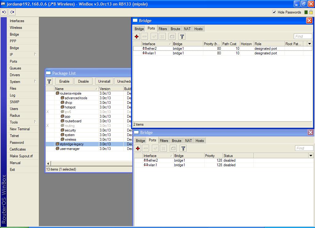

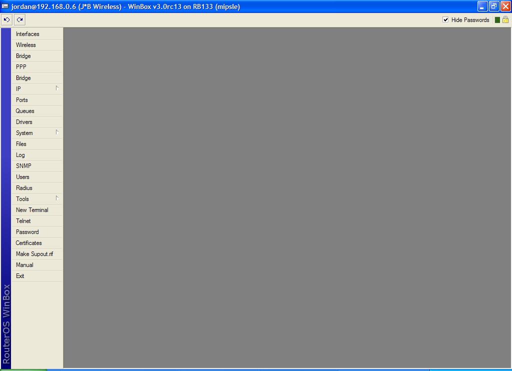

Winbox, dublicate package :-?
Does anybody seen anything wrong in this picture HMMMMMMM… I do! Thets see who get it first lol… I dont know if i did this or what… but its there…
Editising, Does adding stpbridge-legacy, add another bridge icon in winbox? because i saw that package and made me think that is what it is…

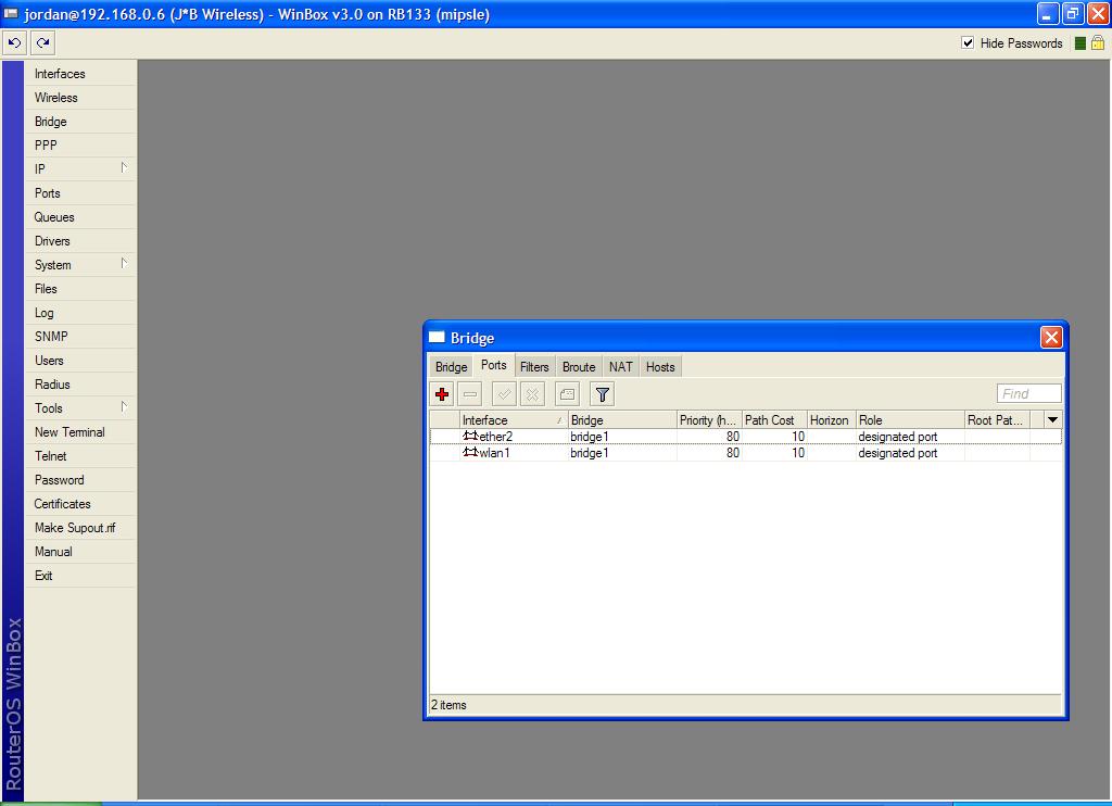

Downloaded 3.0 now, Also i updated to winbox 2.2.13, Here is a picture, You can see that the top bridge had designated port, and the bottom has disabled… sooo just thought it would be helpful. But im sure after upgrade it will be gone because stb-bridge-legacy will be gone… but that is just a guess on my part… -Jordan
Version is still 3.0rc13 on screenshots.
Give us new screenshots from 3.0 version.
I believe stp-bridge legacy package is available for 3.0 as well.
I do not know, why this package could be useful, but if there will be any problems. Let us know.
fixed!

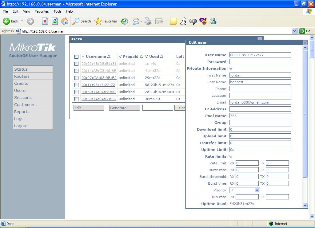

And on a side note sergejs, what happened to the comment feild in usermanager, The automated billing script required that, but i beleive he could edit the script to use The “Group” section of usermanager… Just curious to see why there is no comment feild in usermanager under users.. Thanks -Jordan
Jordan,
You are saying that comments for ‘tool user-manager user’ have gone after upgrade ?
No im saying in the web based program when i go to MyrouterIPaddress/usermanager, Under users there is no place to put a comment, if i put it in using terminal doing /tool user-manager user comment> Numbers:>comment: …
is this correct and there is no visual recognition of the comment feild?
See attached file, no comment section in user…
This mite be something very stupid on my part but it would be handy if the comment feild was in the web version rather than typing it in termianl? Thanks -Jordan
Edit, And this has always been like this for me before and after upgrade, The only thing that shows up is group, which im not even sure what is good for..
Jordan,
next time it is better to ask questions about User-Manager on User-Manager section of the forum.
there is no comments from console available in web interface (there is not comment field at all at web interface).
Comment field will be added in the future.

Yes, I had the same issue (two Bridge icons in winbox) with v3.13 and newest v3.17 and after I removed (uninstalled) stpbridge-legacy package everything was back to normal again - Only one Bridge icon in the Winbox.
