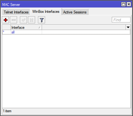

I don’t know if this is useful but this is what I have showing as being enabled:

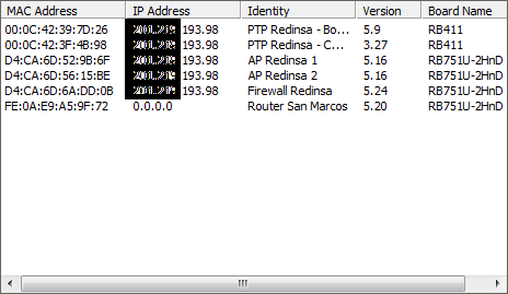

Hi all guys.
I have the following problem with Winbox discovery of devices.
I have a network behind a RB751U-2HnD router/firewall and there are several other mikrotik devices on this network. When I click the […] button on Winbox, all internal devices appear but they appear with the Public IP address that the RB751 router has assigned to do the masquerading. So, I can’t access or know the actual internal IP that each device has configured.
Have anybody faced this issue?? If anybody knows how to fix it, I would appreciate your help.
Thanks all and kind regards.
