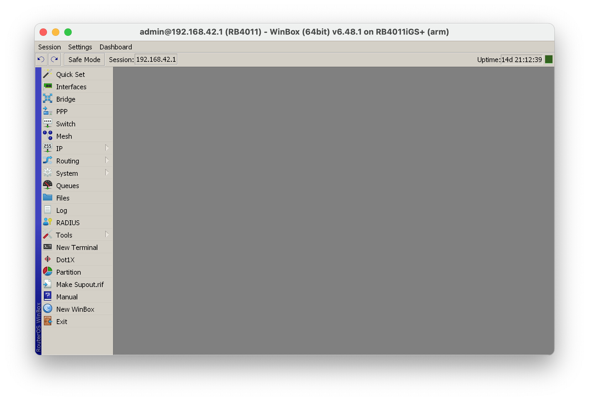

I’m running this on Big Sur without problems:
https://github.com/nrlquaker/winbox-mac
Despite the installation instructions, it runs perfectly and self-contained without need for HomeBrew.
Just Download the ZIP using the green “Code” button. Unzip it and double click the contained Winbox-mac(.app)
