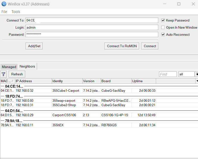

When running Winbox on a Windows PC at one location, I can see in Neighbors the local MT devices.

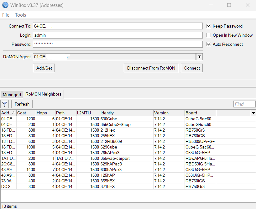

When connecting to any MT devices (locally or at any of the locations remote to this location) using ROMON, I can see in Neighbors all the EoIP-connected MT devices.
Is there any way to be able to see all of these other MT devices in the Neighboors in Winbox without connecting to another MT device via ROMON?

Here are some screenshots:
Should be doable if you enable neighbor discovery for eoip in IP->Neighbors and add your eoip to bridge
Perfect!
neighbor discovery was already enabled, but I didn’t have the eoip interface in the bridge.
Thank you very much!
