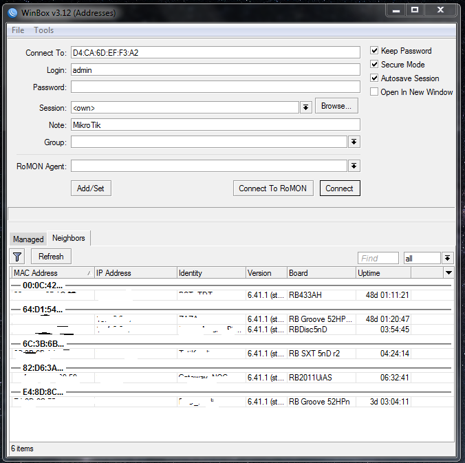

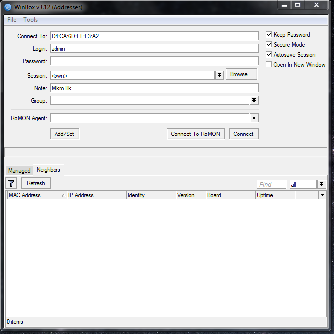

Hello Mikrotik Experts! I am having a unique Winbox problem to connect with routerboard. I have Groove 52HPn and trying to access this on my Windows7 PC through Winbox, but Winbox is not detecting this in its neighbors window. But when access the same Groove with the Winbox on Windows XP PC it gets detect in neighbors window easily and get the Winbox login without any problem. Please assist me whats the problem and where is the problem and how to fix this. Any valuable help will be greatly appreciated. Thank you.
Please refer to the attachment for the Winbox screenshots on different windows.

Hello jspool! I am afraid to say that after fully updating Window 7 and connecting and testing with Winbox again on this updated Window 7 laptop still can’t detect the connected Groove in neighbors window. While detected easily on Windows XP after just connecting the Groove. All other router boards are detecting on this new Windows 7 laptop before and after updating, but not this one Groove only. While on Windows XP everyone gets detected easily in Winbox including this Groove. If Groove would have faulty and/or any other problem it must not even be detected and login with Windows XP, This is really strange issue with Mikrotik router board problem i came across first time and still looking the the solution and reason, why this is happening so and where is the problem and how to fix it. Thanks.

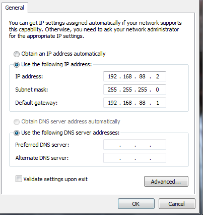

Out of interest if you give your Windows 7 machine a static IP (192.168.88.2/24) can you log into or ping the groove?
Hello Steveocee! Thanks for your support. Please refer to an attached screenshots of my connected Groove, But afraid to say still no detection in Winbox and can’t login and ping the Groove.
