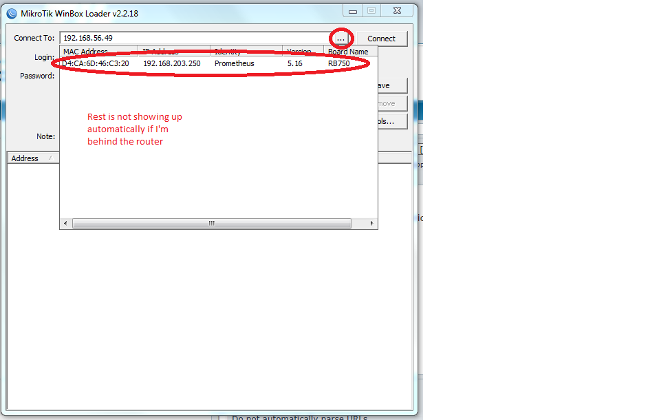

Hi all,
I have a computer behind RB750, when I click on [...] in Winbox , it should list all my detected Microtic devices in my network, but I only sees the router which is in front of me. (See attached picture)
Please people! Answer me, how can I make this work again if possible .

This is exactly what a router is supposed to do. The discover protocol of RouterOS devices works when
the devices are on the same broadcast domain, and in your case they are not, since a router is sitting in between.

The discover protocol is a Layer 2 protocol, as such it is not routed (discarded by router).
So, I don’t think you can forward that kind of packet through the router. Actually, I never bothered
to do such thing, so if any one has managed that, than okay.
The only way that I know to make this work is only if router is configured as transparent bridge.
Yes i assume this, from my configuration ether1 is the WAN port.
I haven’t tried this but i assume it will help by enabling discovery on ether1 port (wan) so that your router receives discovery packets from other mikrotiks.
Winbox uses discovery protocol, which in turn is a Layer 2 protocol. It just sends a broadcast packet on port 5678 on udp protocol.
The broadcast packets are never meant to pass through the router, they are only confined within that particular broadcast domain
from which the packet is generated.
Enabling the discovery protocol on the router (which by default is enabled on all interfaces except on WAN and wireless interfaces)
will discover devices on that port but will not forward that information on the other network. So, by the stand point of a router, you
can see all devices on all the networks that the router connects. But a device behind that router will only see those on the local
area network.
