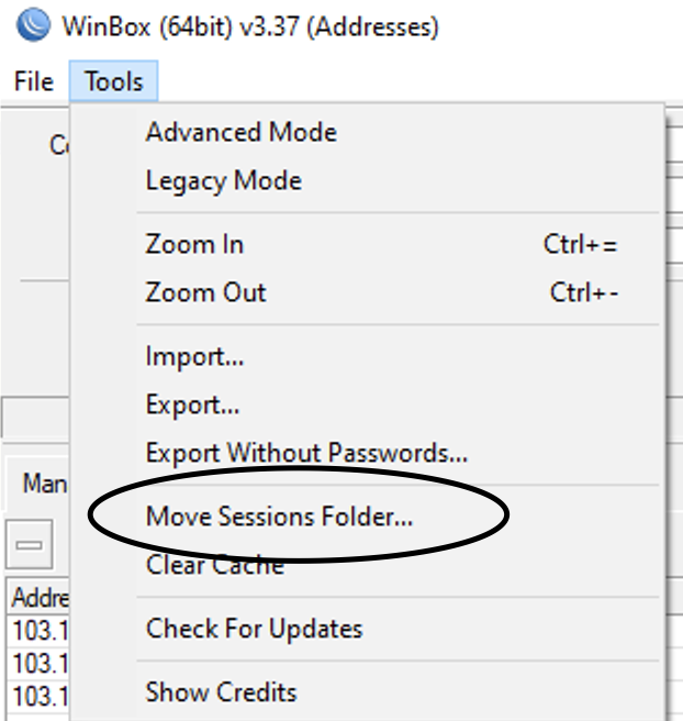

Hi All
If you are facing winbox suddenly close as soon as open then follow below
before click on connect, Click on tools > then click on Move Session Folder > Delete session folder and try to login
it should work fine
