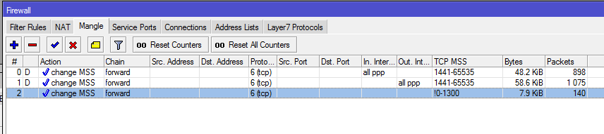

Here is the output of my mangle rules:
 /ip firewall mangle> pr detail
 0   chain=forward action=change-mss new-mss=1300 passthrough=yes tcp-flags=syn protocol=tcp tcp-mss=!0-1300
[admin@MikroTik] /ip firewall mangle>
Dont ask me why mikrotik doesnt display the dynamic rules there. It should shouldnt it? Should I file a bug for that? Screenshot attached.
The change you suggest has made no difference to ping size and also the Winbox session still does not work.
What other suggestions do you have?
Best,
Alex

Hi Alex,
Yes, the dynamic rules should be displayed, that is probably a bug. Can you run a packet capture of it while it is failing? That will probably the best clues as to what is going on. Will you also post your configs from both routers?
