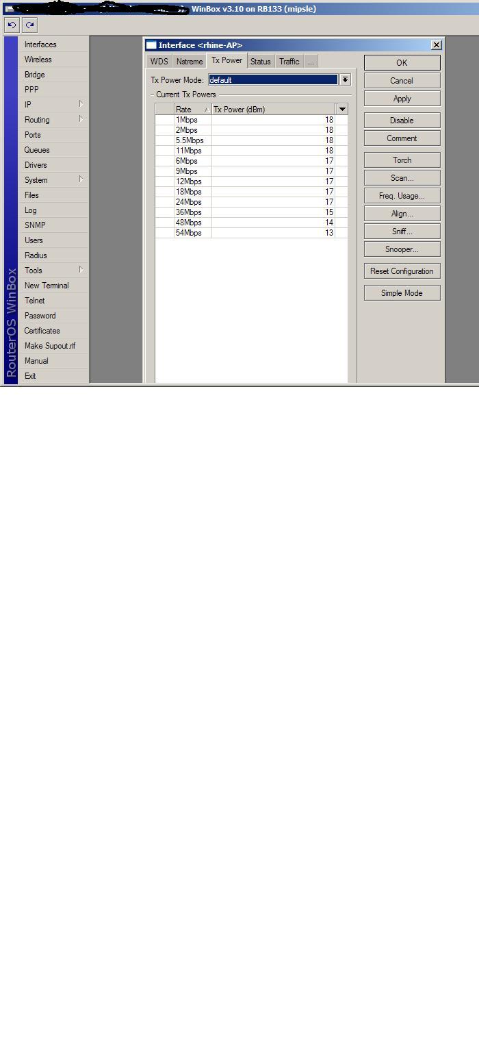

WinBox Tx Power display seems 10 dB low
I’m looking at the WinBox window Wireless-> Interfaces → Tx Power which is currently configured for “Tx Power Mode: default”. Under that display is a table of “Current TX Powers” which shows what power the radio will use at different transmit data rates.
The power level starts at 18 dBm for 1 Mbit/sec and then drops as expected past 11 Mbits/second.
The problem I have is that the mPCI radio card is an Engenius 8602+S and is supposed to go up to 28 dBm (600 mw).
I’m viewing this on a RB133 running ROS 3.10, BIOS 2.16. It would appear that the RB software is confused, or should I blame the radio?
I wonder if it’s running at it’s full power of 28 dBm or the indicated power of 18 dBm.
I’ve looked at the documentation and I can’t find anything that gives me insight into why the 3.10 display shows only the lower value.
This would make a little sense if I was using frequency-mode=regulatory domain and I had a high-gain antenna. However, this is not the case.
Does anyone have any insight into this? Is RouterOS confused about the transmit power? Is my Engenius card confused? Is this all fine and I am the only piece of the picture that’s confused?
I also have ROS 3.10 running on a RB411, and it also shows the lower values, starting at 18 dBm when I expected to see 28 dBm.
I don’t have a power meter, so I can’t tell what my signal strength really is.
If nobody has an idea about this, I’ll submit it to support with a supout.rif, but I wanted to see if I’m missing something obvious.

Can you post a screenshot?
Here is the screenshot showing maximum power of 18 dBm. The Engenius 8602+S is spec’d as 28 dBm, 600 mWatts.

Mikrotik show a 28 dbm cards as 18 dbm as cards TX power value. They have -10 dbm difference for those high power cards like XR2, Engenious etc. When you login into MT winbox,
you will see 28 (18) dbm TX power for XR2 cards that means your card is running at full power and mikrotik count it as 18 dbm ! If you set card TX power as 26 dbm, it will show you 26 (16)
or just 16 dbm. Don’t get nervous !
So its not a matter to get worried as all settings are working perfectly. I had a same question too a few months ago and came to know this trick !!

If you had looked at the screenshot above you would realize that the OP’s concern is this card Isn’t showing up that way.
As litu points out, MikroTik has dealt with the Ubiquiti driver issue by applying the known 10 dB error between what the driver reports and the actual power and using parenthesis to indicate both the value reported by the driver and the correct value.
However, as jwcn points out, I am not using Ubiquiti cards, I am using Engenius cards. No offset is applied and no values in parenthesis show up.
I just finished some testing of actual power levels, and found that the levels reported by MT when using an Engenius 8602+S card are 10 dB lower than the actual power level.
When I use the default setting, WinBox shows 18 dBm, but I measure 28 dBm.
Using “Card Rates” and entering 17 dBm in the box, results in a measured transmit power of 28 dBm.
Using “Card Rates” and entering 13 dBm in the box, results in a measured transmit power of 23 dBm.
Using “Card Rates” and entering 7 dBm in the box, results in a measured transmit power of 17 dBm.
In conclusion, when using Engenius/Senao 8602+S cards, the actual transmit power will be 10 dBm higher than what MikroTik displays and what the user sets.
If you want to limit your transmit power to 17 dBm, you must set “Card Rates” to 7 dBm.
MikroTik points the finger at Engenius (see earlier post in this thread). Engenius points back at MikroTik for not having a compatible device driver.
Either way, I suggest MIkroTik investigate this and confirm my findings and use the same or similar format to report the power as they do with Ubiquiti cards.
