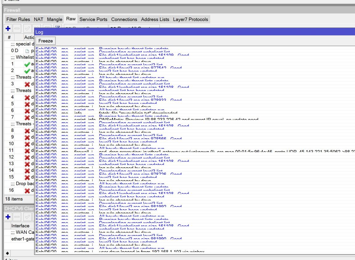

Had to downgrade back to 3.20. Does not work well with a resolution of 3840x2160. Log was unreadable with lines overlapping.

Increasing DPI to 120 and 144 stay great on menus, but log became more unreadable because increase the overlapping.

Log text lines is overlapping on 1440p monitor, 150% scaling. There’s no problems in other menus.
Windows 10 (1909).

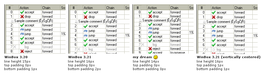

I’ll go slightly against the flow. Everyone seems to want things bigger, but I’d rather have them smaller. Or maybe better term would be more condensed. It’s about one specific thing, line height.
With “standard” DPI display, WinBox 3.20 had lines 15px high. WinBox 3.21 has 16px. Right, it’s just 1px difference, i.e. nothing. But it adds up. With fullscreen WinBox on FullHD resolution, I was able to see almost 56 lines (e.g. firewall rules), but now it’s only 52. I won’t give up RouterOS because of that. But I really like seeing more without scrolling, because it’s practical.
So I have a suggestion: Keep 3.21 line height as default. Even I will admit that it probably looks better, if we’re talking just about appearance (and it would look even better with vertically centered text, see last image; now it’s alligned to top). But add a “condensed mode” option, which would leave out padding. With that, I’d be able to see almost 62 lines. And 62 compared to 52 is good difference.
Implementing this should be really easy, since you already have different line heights depending on DPI, so it’s just one parameter used for calculation, and one on/off option in menu.

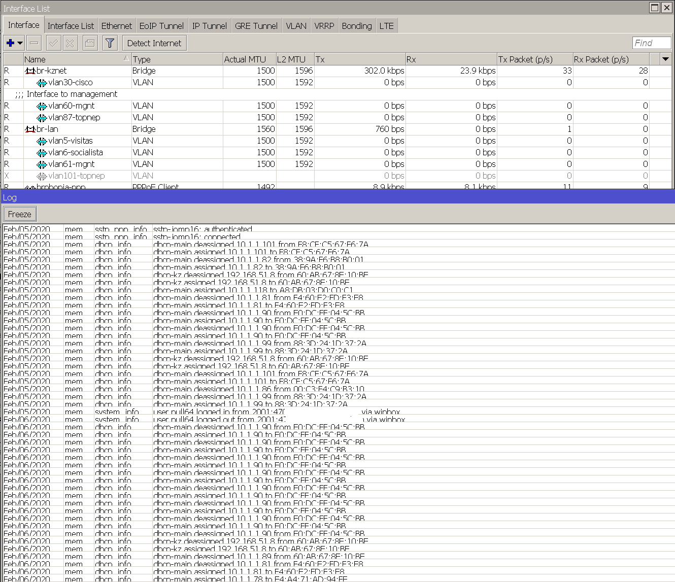

Wanted to report I’m having similar issues with viewing the log on a Windows 10 4k display, 225% scaling.
Attached is a picture of what it looks like to me. My guess is that it’s not yet honoring the DPI scaling.

hngjared, sid5632, null31, hel, brotherdust, proximus - We will resolve this problem in upcoming RouterOS releases. Winbox 3.20 is available here - https://download.mikrotik.com/routeros/winbox/3.20/winbox.exe (winbox64.exe for 64bit version)

Sob, MichalPospichal - We will change default line height in upcoming WinBox releases
