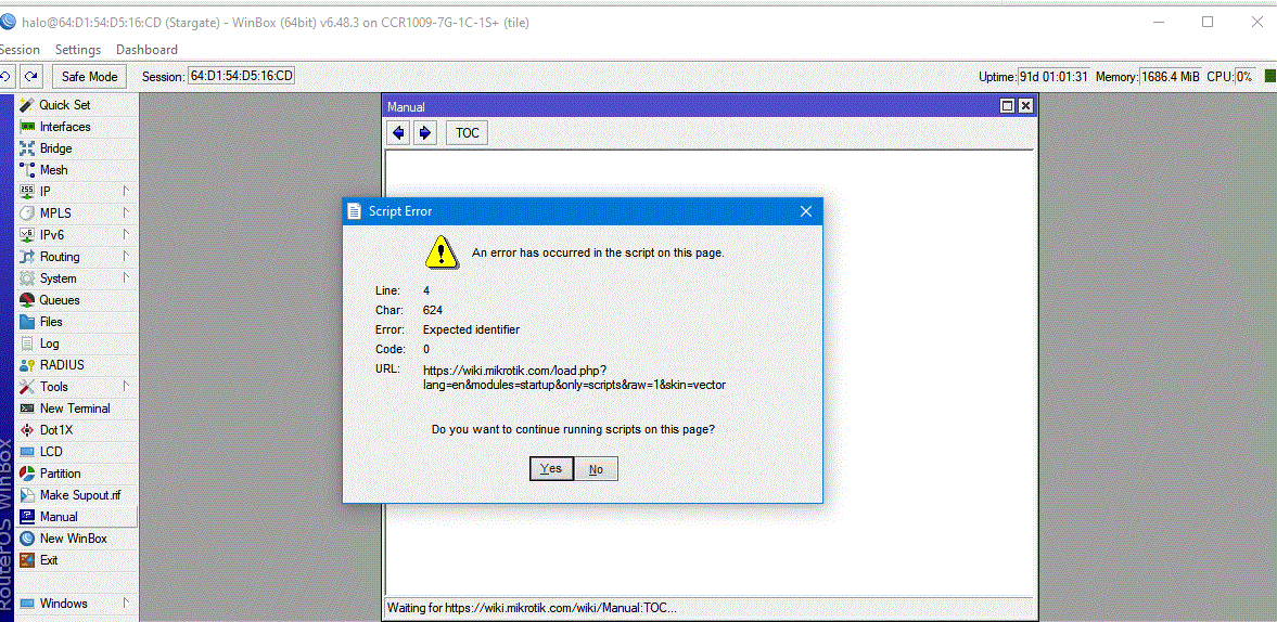

From Winbox when launching Manual the following Script error makes its presence known:

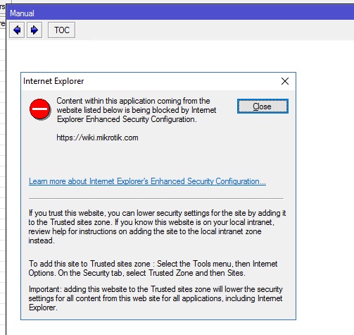

On Explorer you get this when click on manual:

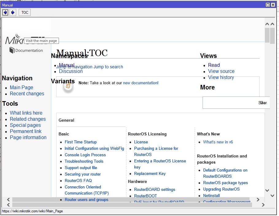

It does open when click close, but I do see som formatting errors:
Exist a “manual” inside WinBox? I never noticed or used it… :)))
