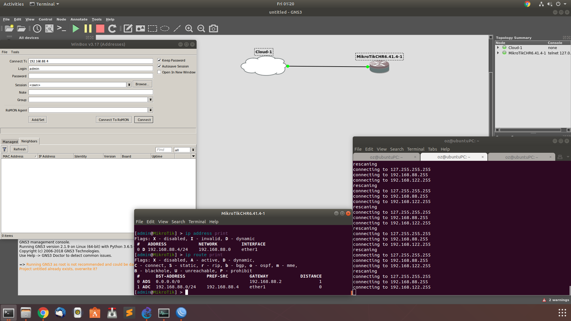

I am running latest Winbox via Wine to access my CHR. But it neither is discovered in neighbours nor it connects via its IP. I have connected the CHR with my physical interface via a cloud. And the CHR is obtaining an IP via DHCP from my router. See attachment for all information.
Please tell if any other information is required.

I enabled firewall also and explicitly allowed 8291, but still it doesnt work. Moreover, I cannot get to the router via browser also.
If it is getting DHCP I don’t think there is some issue with IP config or routing, right?

Showing in neighbours is not the problem, but it wont connect via IP aswell. I would also like to add that I am running GNS3 as root since running as a user wont allow KVM the permissions.
