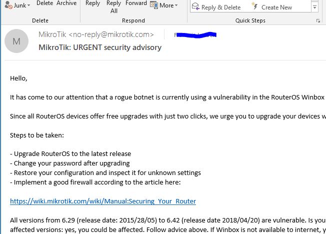

This morning I received a mail directly from Mikrotik re vulnerability
I got the same Mail two days ago so perhaps they’re having problem with the mail systems ? :wink:

It’s disappointing that both the httpd vulnerability and now the winbox vulnerability required mass exploitation before Mikrotik sent an email. Why not send these emails on day 1?

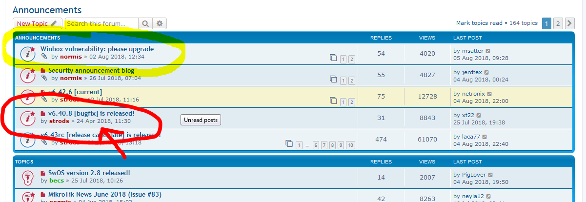

43north … you are using our forum … you are posting … why have you not upgraded your router earlier even you have had (I suppose) knowledge of the problem?
Honestly I had never read the announcements section of the forum, I do now… and will from here on out. My ignorance cost me, I know. Never again.

43north … please do not take it personally :slight_smile: but this is the quotation of the month … maybe even of the year.

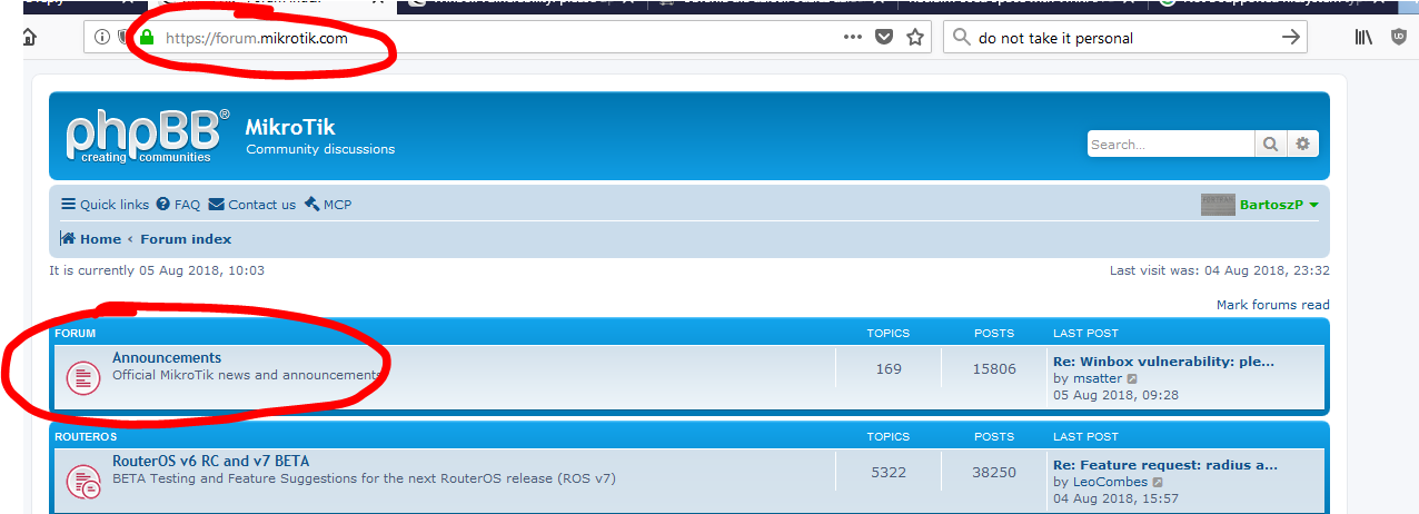

I keep an eye on the active topics that shows all postings that are recent. The trouble is that important postings like vulnerability posting drop as fast of the rest.
They are swiftly out of sight and you will miss them if you don’t check in, several times a day.

msatter:
https://forum.mikrotik.com/
or
https://forum.mikrotik.com/viewforum.php?f=21
I think this one would be very useful. I for one am subscribed to multiple ones already, and do pay attention to what’s announced there since they always concisely describe the issues and give the CVE number(s) where one can see the in-depth details. MT issues regular product and update emails, this is at least as important if not more. It’s not enough to list simple update bullets like usual, the email sent out on the 2nd was by far more effective because of its detailed contents and warnings issued.

Course I know where announcements a located, I am not stupid.
I am calling for doing that bit extra to inform all and keep an important notice im the picture.Creating the notice in announcements hope al is going being right from there is not working as is proven now.
Mikrotik has room improve also with the blog and if we keep fighting eachother like we are doing now, instead of thinking how to improve the whole Mikrotik eco system.
It may lead to Mikotik thinking we have still support how we are doing, have all done in the past and so keeps sitting on the sideline.
If that happens, and it looks now like that, we will have the same discussion again all over in time.
Atleast send a mail to the Mikrotik certified members
