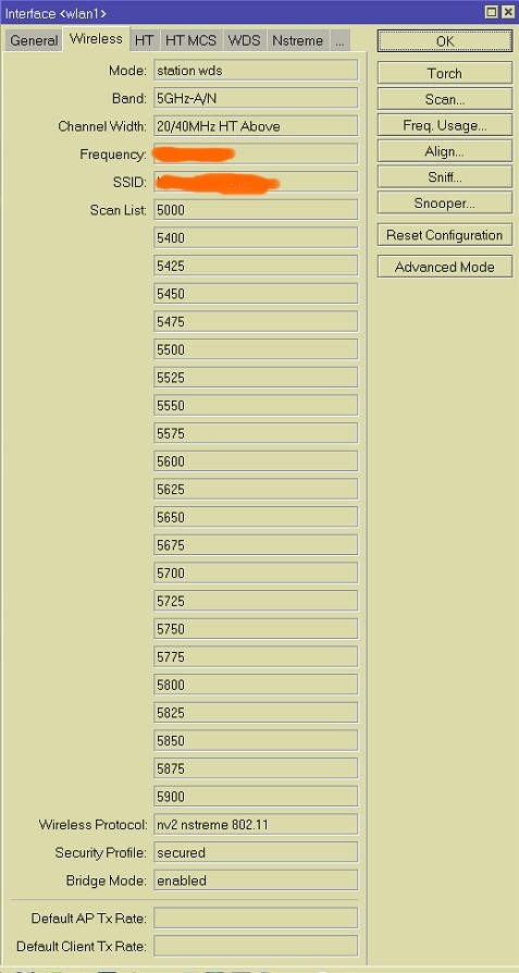

From version 6 i see problem in wireless card settings in winbox.
If there is more items in scanlist, there is impossible to resize window.
The CLI configuration looks like:
set [ find default-name=wlan1 ]scan-list=
5000,5400,5425,5450,5475,5500,5525,5550,5575,5600,5625,5650,5675,5700,5725,5750,5775,5800,5825,5850,5875,59001
In the winbox it looks like in attached screenshot..
If you try to resize window, it will be stretched verticaly to maximum, and you can never go to hidden items at bottom.
It looks like a bug…
Define a scan list, and set the scan list name here. Why are you writing frequencies in there? This field should contain the “name” of the scan list, not the frequencies.

OK, it looks like my bad in scanlist definition,
but your answer didn’t solve problem with window resizing if there will be more items. :slight_smile:
I’m right?
Martin
In this window, there should be no more items normaly :slight_smile:
while you can do as shown in the screenshot, it is not how this should be done. There are places where something like this can be done, however in all cases such configuration just does not make sense.
In your case, go over to ˙/interface wireless channels’ and define list that contains what you require
