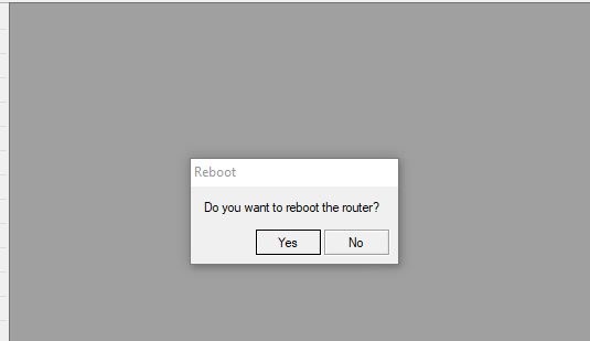

Anybody else been having issues with winbox popups not working with Windows 10 last update ?
The OK button does not work anymore – Also cant Do you want to reboot the router .. cant click on yes or no

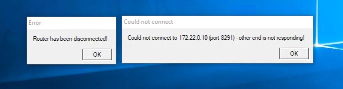

Winbox release 3.11 solves problem with internal popup inside winbox shell. For rebooting router can click yes or cancel and it works fine but problem persists with popup when using wrong username or password for login or when router is disconnected I cannot click OK button to close that window.
Only way to kill that popup window is through the Task Manager in Windows 10.
