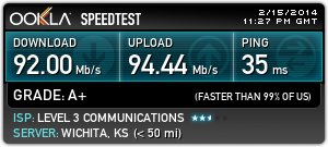

Then I started increasing MTU on link with AirFiber, First I moved the connection to port 9 so that I could use 9000 mtu and 9116 l2mtu, I changed the rb1100 port 10 to match
I started to see performance gains, the btest to the 1100 got up to 70mb both ways and my speed test was around 64 mb. But I noticed this soaked the CPU on the 1200 so I read some more about best ports to use on the 1200, I switched back to port 5 changed the MTU to 3000 and maxed out the layer 2 mtu to 4060, I changed the rb1100 port 10 to match. Now I was getting consistent over 90mb on both btest and speed test. I then tested to a public speed test server and got excellent results.
