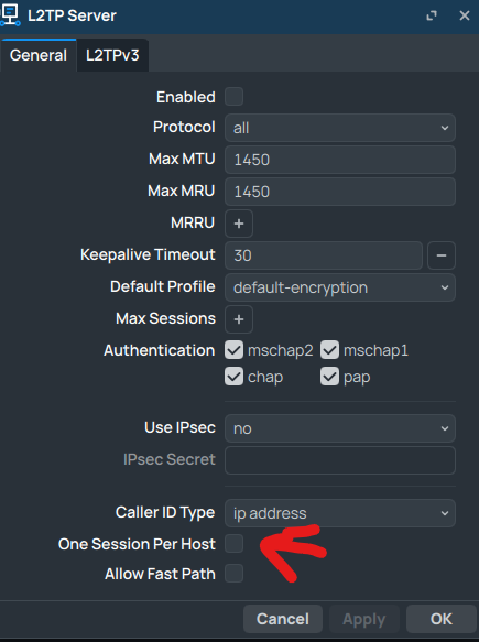

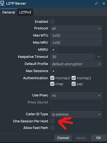

I had to temporarily stop restarting my Windows VPN + MikroTik setup because I urgently needed a remote connection. So I started an L2TP + IPSEC server on the MikroTik, and everything worked—the VPN on the MikroTik router and RDP. It worked fine until a second user tried to connect, but then it kicked out the already logged-in user. This means that MikroTik doesn't allow more than one user to connect. Is there any way to fix this?
