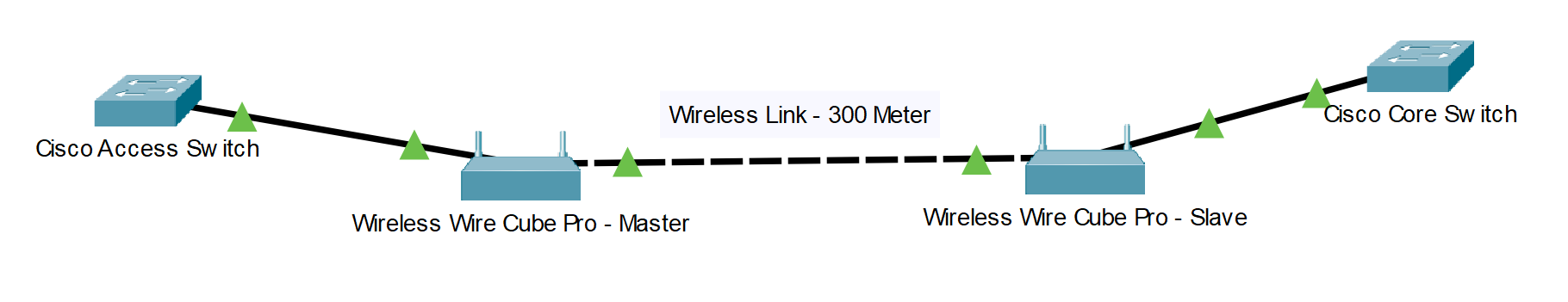

Recently I bought a pack of Wireless Wire Cube Pro (This is a pre-configured kit of two Cube 60Pro ac devices).
https://mikrotik.com/product/wireless_wire_cube_pro
Here I created a map. Two Cube 60Pro ac are connected together and on both side we have a Cisco switches.
But I have new issue. I test embedded bandwidth test between two devices. Tested in receive, send and both mode. All of them show just 1.2 Mbps. The distance is 300 Meter.
We have a line of sight. I even test it with laser measurement device to make sure its align. There is no obstacles in between.
I even test it in a room with distance of 40 Meter, same results.
I didn’t test 5Ghz yet.
Have any solutions?

Judging from people having issues with them that posted on the forum it is however strange, the reported issues I have seen are mostly with difficulties in connecting to them, not about (so much) slow links, is the behaviour the same if you do the test instead of through the CISCO devices between two PC’s (or between a PC and the Cisco device on the other side of the wireless link)?

Thank you bro,
I checked with PC on both side, sounds better to me. I assume there is some policy for devices in between.
