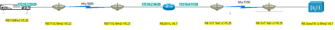

For example, consider this scenario:
From RB-OmniTik to RB2011 i have like 40Mbps. From RB-OmniTik to the first RB 711G-5Hnd v.5.23 I have 7Mbps. Please pay attention that there are no new wireless hop, because the 711G-5Hnd is connected by wire to the RB2011.
BUT if i test the ethernet wired from RB 711G-5Hnd to the RB2011 it performs 98Mbps (!). So there is no a wire issue.
If i test from the RB-OmniTik to the last RB1100H2 i have 7Mbps.

I will try to set the distance. But, as I said, it seems the problem insn’t related to the wireless itself:
A=====>B---->C====>D=====>E
where:
— means wireless
=== means wired ethernet
a=Omnitik
b=RB SXT-5Hnd
c=RB SXT-5Hnd
d=RB2011
e=RB711G-5Hnd
A to D = 40Mbbs
A to E = 7Mbps
D to E = 98Mbps
why this uge difference from A to E ? the only diffierence is a 2 meter long ethernet cable, that WORKS because D to E is 98Mbps. I expect A to E at least 40Mbps like A to D.
