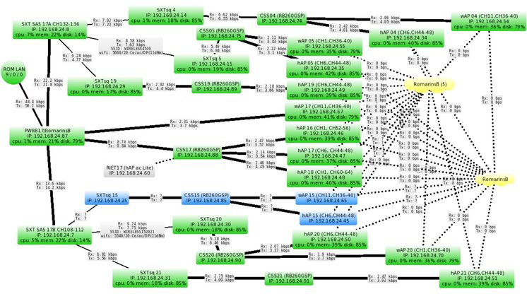

Characteristics of this setup:
  • 4 network like the above in total , each network uses one IP subnet (4 DHCP servers for 4 networks on main router), large 1 km2 area
  • common central router to load-balanced internet access, common RADIUS server
  • network is one L2 broadcast domain, PtMP links are “AP bridge - Station bridge” links, all interfaces are port to bridge
  • one SSID name for all client access in one network, common name for 2.4 and 5 GHz (ssid A,B,C,D exists in total)
  • MT does not support fast roaming (connect before disconnect), but IP address and sessions remain open while roaming within same SSID
  • no CAPsMAN used
  • clients authenticate via EAP/PEAP/MsCHAPv2 RADIUS, WPA2/Enterprise
  • roaming triggers RADIUS authentication, but not DHCP renewal, no new NAT sessions in the main router, no new TCP sessions
  • excessive broadcasts (Apple Bonjour, Windows NBT, etc etc) mitigated with “same horizon” in bridges.
  • roaming between A,B,C and D networks (different SSID!) is new IP, and of course new NAT sessions, new TCP sessions
  • all bridges and switches set as “dump” devices, no VLAN filtering. However VLAN is used, for some AP to allow them to serve multiple networks.
  • 200+ client devices, works very well. Roaming still is a short 1-2 sec interruption/delay of traffic. (no 802.11k/r/v in MT)
