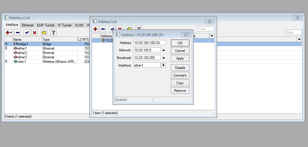

Only issue that I need help is to put IP on AP, so I can ping to find if there is a problem for future operation. I am using DHCP from RB1100 and our IP settings are 10.20.100.0/24 GW 10.20.100.1. Do you think I should put a static Ip on RB433AH AP?
Yep, I would put a static on it. Make sure you put it on the bridge interface and not the ethernet interface.
So is this not true?
That might work but it is best practice to put it on the bridge interface.
Thanks a lot Chris, it worked.
