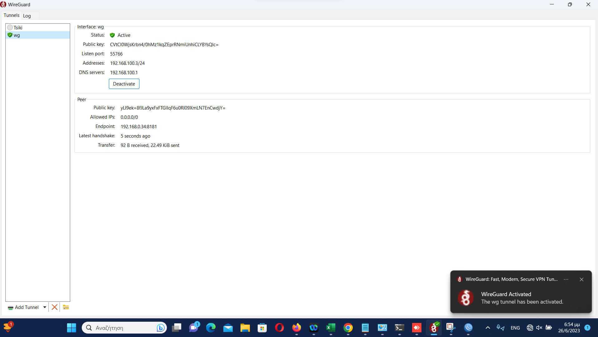

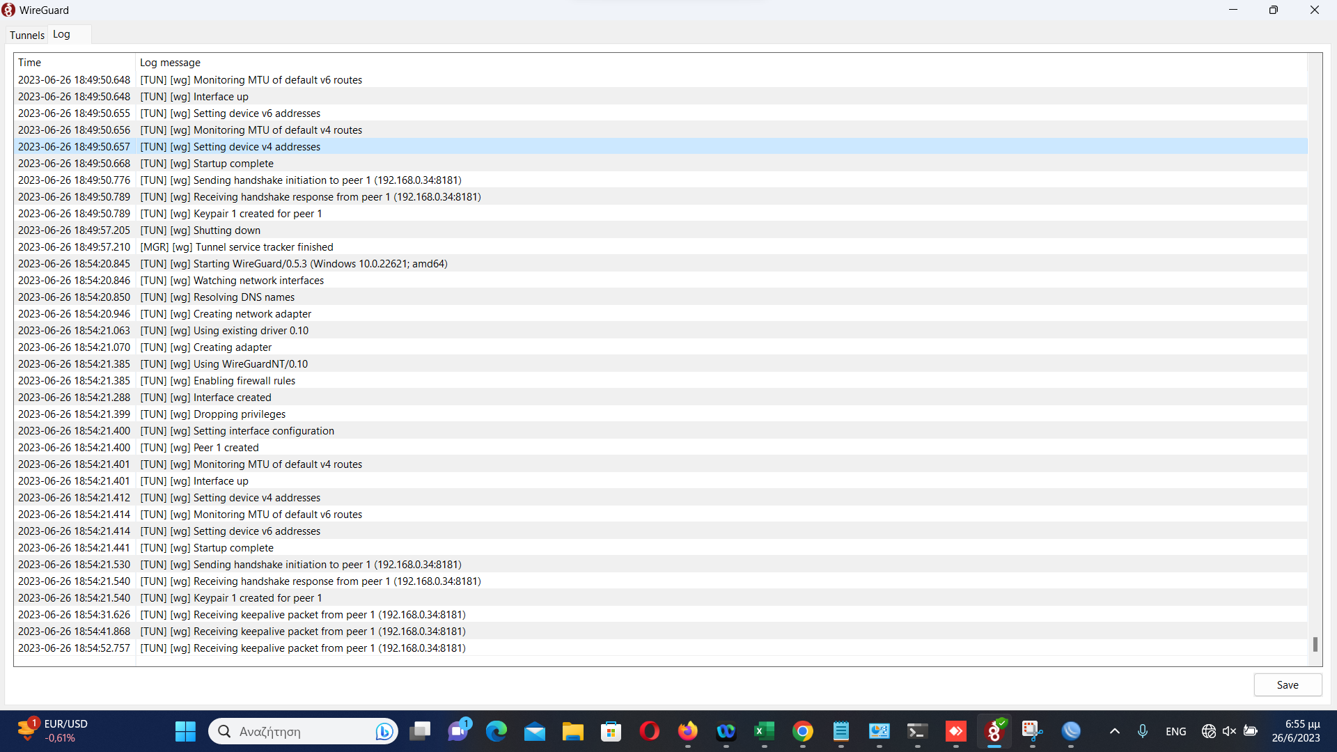

Now while making changes i realize that handshake complete only when the client is connected in the MT wifi/ethernet but not from outside.
Maybe these is the problem.
In ISP router i have port forward the port 8181 udp but when i check in portchecker it is showed as close.
