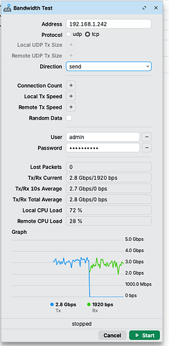

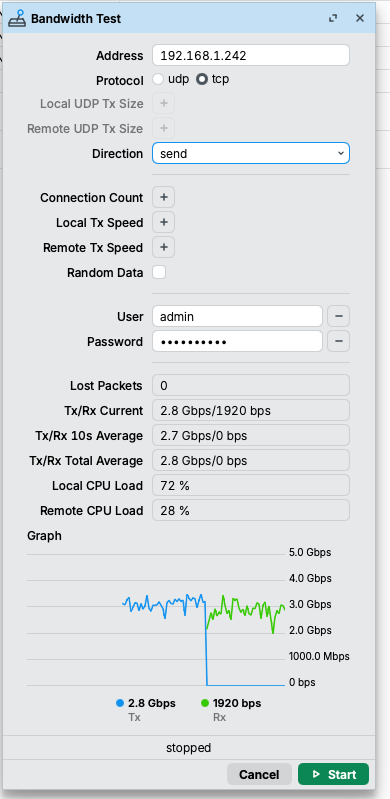

Results:
Testing over a "LAN" connection (no Wireguard) showed speeds of roughly 3 Gbps:
The 5009 IP address is 192.168.1.1. The "WAN" interface of the virtual router was 192.168.1.242. I also had another ethernet interface added on the LAN side, but speeds were unchanged. So there's not a speed drop going through the router interface.

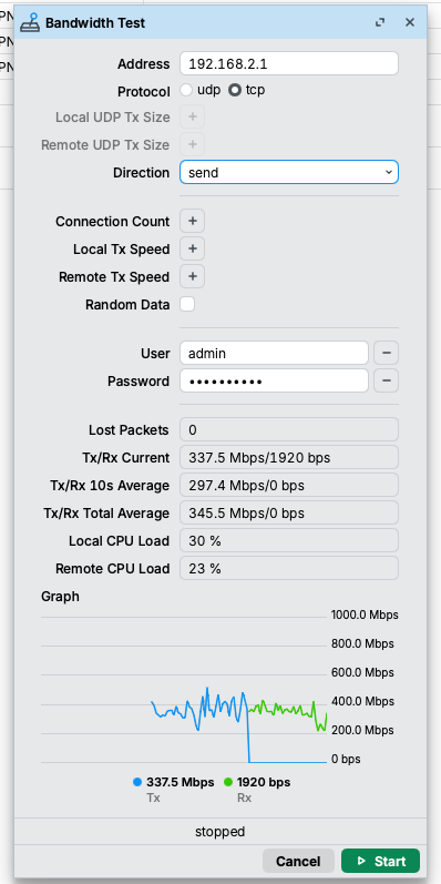

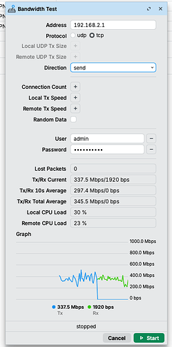

Now for the Wireguard connection:
A significant difference! 192.168.2.1 is the WG endpoint on the virtual router. No matter what I tried, I can only get 300 to 400 Mbps at best out of a WG connection between two Mikrotik router instances. This really dovetails with what I am seeing on my remote CHR. Very similar performance.
I don't think there's anything in the firewall or router settings that would alter this.
There is a bug in Winbox though. In the images shown, the TX and RX colors are reversed.

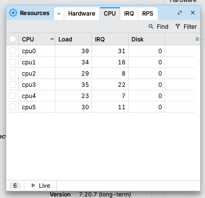

So I've tested between my CHR and home over the internet and on my LAN between my 5009 and a CHR running virtualized on my QNAP.
Here you go. Doesn't seem like WG is single core...
5009:
Virtual Router:
