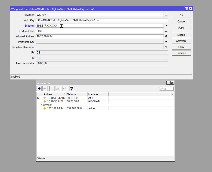

I made the changes but still no luck:
Client:
2023-08-13 16_52_45-admin@48_A9_8A_11_5A_54 (MikroTik) - WinBox (64bit) v7.7 on hAP ax^3 (arm64).jpg

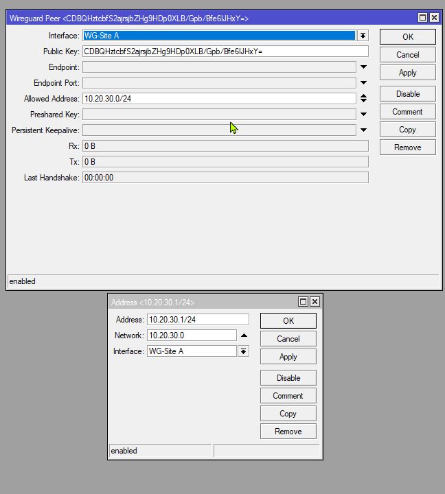

2023-08-13 16_53_14-D45aAR@vpn4.remotewinbox.com_44578 (MK-5009-Ongar) - WinBox (64bit) v7.10.2 on R.jpg

Rx counter remains at “0” on the “client” side ?
It should at least try from the hotel to reach the endpoint right ?
Correct counter “0”
Odd thing is the iphone and laptop are reaching the server endpoint but the MT doesn’t seem to want to handshake
Double check the keys at both ends.
at client MT
ADD persistant keep alive on the MT at lets say 35 seconds
At Server
the Allowed IPs for client peer should be 10.20.30.2/32
at client MT
At Server

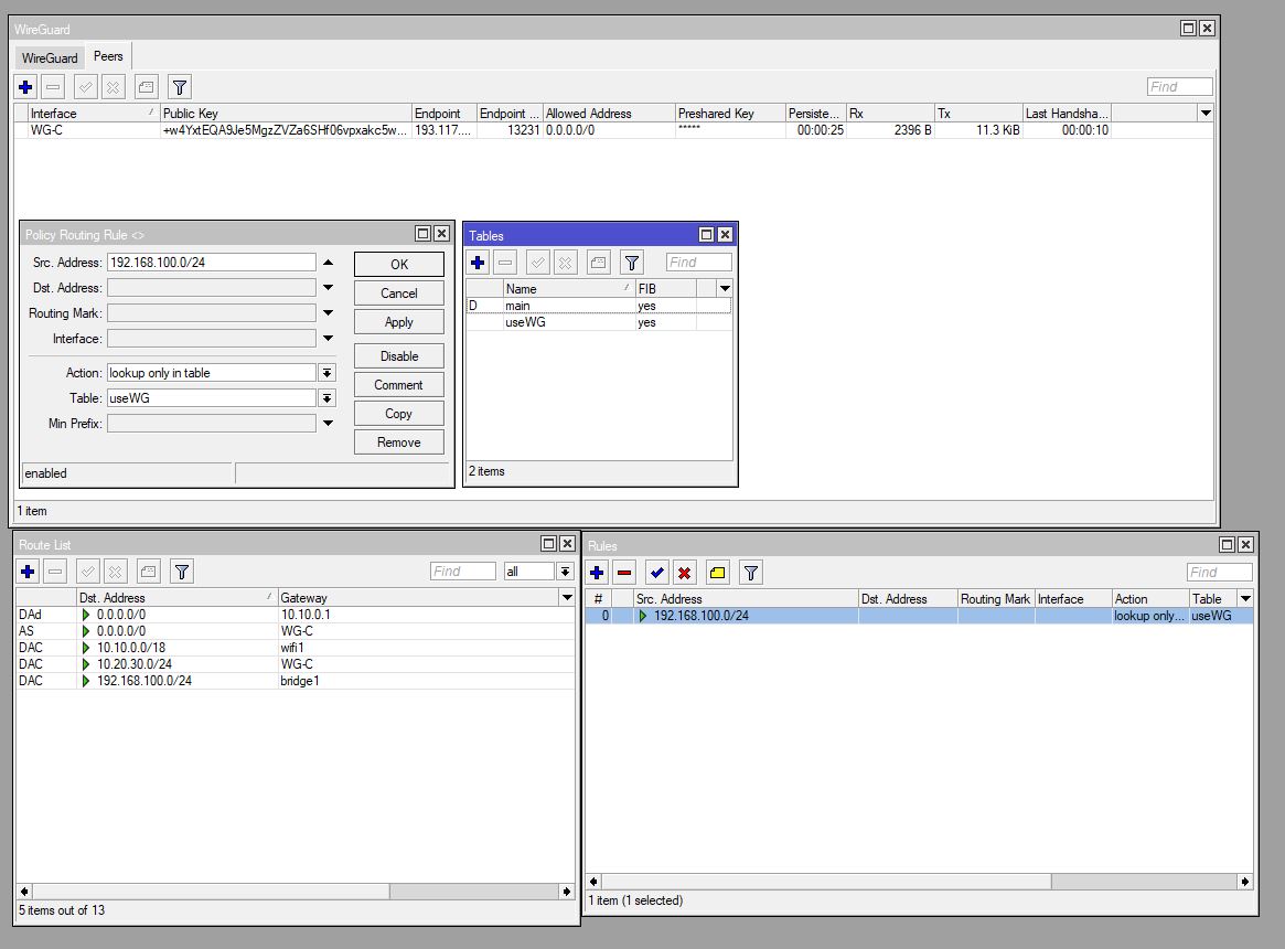

I did the three things but no luck, traffic still not going thru wg, probably something really silly as usual,
2023-08-14 14_43_00-admin@48_A9_8A_11_5A_51 (MikroTik) - WinBox (64bit) v7.7 on hAP ax^3 (arm64).jpg
Please post configs at both ends.

MAIN ISSUE
/routing rule
add action=lookup-only-in-table disabled=no src-address=192.168.100**.254/32**
table=useWG
Change to
/routing rule
add action=lookup-only-in-table disabled=no src-address=192.168.100.0/24
table=useWG
