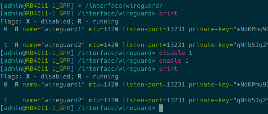

  1. When adding a new wireguard Interface, if I set the port 51820, the interface never becomes Running and its not possible to start it. If I specify any other port it works fine.
    This behaviour was observed on several RB4011, RB960
    However, when the same was tried on CRS309 and CRS326, the interface is created fine in running state.
    So it seems the only way to set WG port ito 51820 is to first create it with some other port, then change it to 51820 later.
    (UPDATE: Ok i understood why it is happening. I already had one Wireguard listening on 51820 that was used as a client, so obviously a second interface that was supposed to be a Server couldnt be created on the same port. There was no error generated or anything, it was just inactive. However, when the interface was created in a different port, and was later change to 51820, it was shown in as Running, but wouldnt come active if I pressed Disable/enable. So thats what have confused me here)

Well, I wouldn’t consider it my error only. If the port is already taken, then the error message should be generated indicating it.
Also, in the situation when the port is changed at the later stage, the GUI indicates both interfaces running on port 51820, which is obvioulsy false. And it actually applies not only to port 51820.
