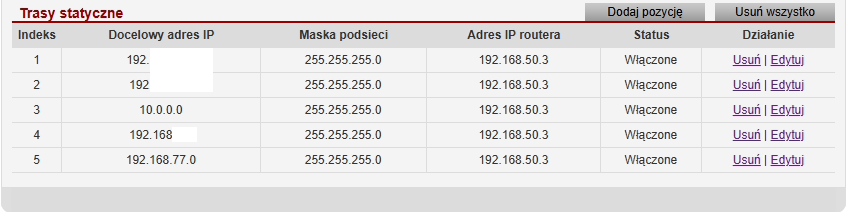

I have set up a Wireguard Site to Site connection between two locations. [ROS 7.16.1]
One has a public IP address, the other one uses LTE from Huawei.
10.0.0.1 - Wireguard Address (for Public IP site)
192.168.77.1 Gate for Mikrotik in the middle of the network
192.168.77.x/24 computer inside this network.
10.0.0.3 Wireguard address for LTE
192.168.50.3 - mikrotik inside this network (exposes Wireguard interface)
192.168.50.1 Huawei as a gateway for the network (+ LTE).
And so the tunnel is set up correctly. At the moment, there are no restrictions on network access, i.e. “allowed addresses” is set as 0.0.0.0/0 on both sides.
And yes,
Routers can ping both wireguard interfaces and devices within the network.
Computers on both sides can ping the interfaces of wireguard 10.0.0.X. However, computers inside these networks CANNOT ping devices inside the network and gateways, i.e. a 77.x computer cannot ping 50.1, 50.3, 50.x and vice versa.
50.3 has no firewall rules.
I tried with masquerade and srcnat but something doesn’t work. Please give me tips :slight_smile:

H_LTE is the main router with the address 192.168.50.1
However, mikrotik on the bridge has the address set to 192.168.50.3. It does not receive addressing on the WAN port. It is simply part of the network behind H_LTE.
