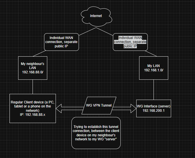

Dear All,
Or should I say Dear Anav already :slight_smile:. I am facing a very strange issue with the Wireguard client connection that works perfectly well from virtually anywhere but the designated desired neighbours local area network.
I have three separate WG interfaces set up (used to have two only and tried to create just another peer for my “WG-External” for my neighbour):
WG-Internal - rather self explanitory used for my household needs
WG-External - to share the net traffic with my family without access to the LAN resources
WG-TheNetwork - a copy of the External, set up for the listen port 51820 to see if the ISP is not blocking this port
Like stated above, I started this journey by simply creating a new peer called “Lukaszek” for WG-External.
I was able to test it out with flying colors using both my LAN connection (so connected from within the same network the WG “Server” is located in) and externally using my 5G mobile data plan - i thought this would be it, all good to go.
I couldnt be further form the truth. I gave out the credentials to my neighbour and he was never able to connect, not even to establish the handshake.
Both networks are Mikrotik based, we do share the same ISP with two separate public IPs handed out by the ISP. When i go to any other neighbour to use their LAN for testing both on Mikrotik and non-Mikrotik based hardware everything works flawlessly. Chat GPT ran out of ideas after comparing the configs all over again - so maybe some of you can pin point some config issue that I missed ruling out any possibility that our ISP is somehow blocking any UDP traffic.
Here is the WG server config file (my LAN):

Any ideas what might be wrong? All Peers work perfectly fine anywhwre else but the neighbour’s LAN. I sit possible its blocked by our shared ISP somehow?
if no handshake, enable logging on firewall rules for port and or source address and confirm traffic even gets near your firewall.
Also if you both have public ip's that means there are other routers involved since i didn't see any config for public ip's or ISP settings.
Could you please make a small diagram of the involved MikroTik's with their correpsonding IP addresses? Bit difficult to understand...
But still...could it be that both peers are set with the setting responder=yes?
That is such a confusing setting. It certainly could be the problem in this case.
Think of it as being the server (the one public ally available). This site requires that Wireguard is available through a socket, the other site can be behind CGNAT/NAT.
Right, but as I understand it (maybe wrongly?), if I want to say “this wg server is the publicly available one”, I do that by setting responder=yes for every peer on that server.
If that’s correct the wording is confusing, and the help doesn’t make it clearer. And I suppose it’s partly due to that peer settings interface containing a combination of “attributes of the remote peer” like Endpoint, and “behaviors of this router when connecting to this peer” like Persistent Keepalive and Responder.
This "responder" thing has been explained and discussed to death on the forum. I think the meaning is abundantly clear: a responder will accept but never initiate a handshake.
Therefore two sides, both configured as responders, cannot create a connection.
It's the same as the ipsec "send initial contact", just in reverse.
The the configuration generation (what the other side should do) and what we should do is mixed together is unfortunate.
My understanding, is that the the Responder checkbox is available for each peer identified on the "server router for handshake" That is due to the fact that the router can interact differently with each client peer as determined by the checkbox. To be clear, this setting changes the behaviour on the Server peer (the router), and not on client devices.
Before we had this checkbox, the 'normal' behaviour was that the Router would not actively seek the client and would wait for the initial handshake (silent mode). This equates to Responder check box being checked. The router is ONLY a responder.......
If we DO NOT check the Responder box, then the router will proactive and try to reach the client peer and it will be proactive or Noisy Mode, not waiting for handshake, to attempt connections.
Why I find this intuitively confusing (LOL), is that the router has no idea what the IP of the client could be prior to any handshake....... Which makes me think my explanation/understanding is lacking somehow.
( it makes more sense to me if one has an endpoint entered but that is not the case, normally )
In terms of the config, not conversant with capsman, so I cannot see for the life of me how you associate wifi to vlans at all.......
There seems to be four subnets but only three vlans, and if you have mixed apples and oranges, attempted to have the bridge be responsible for a subnet, my sympathy wains quickly. Take the subnet make it a vlan and disperse the subnet via /interface bridge ports and interface bridge vlans appropriately.
Since you are sharing the internet ( completely legal in Poland :wink: ) I would definitely create a MGMT interface.
Neighbour discovery would be set to MGMT
tool mac-server mac-winbox would be set to MGMT
(note plain tool mac-server should be set to none!)
If not using iPV6, disable it and remove all associated noise.

here’s my attempt to draw a diagram:
When you have an actual home config to show, that is not full of noise, then it can be made sense of and further since the neighbours router has no peer settings to your router, in the config, it is equally unhelpful, or is he simply using a windows wireguard client and is expressed as 102.168.250.3 on your peer settings???

It's not a site to site type of a connection we try to achieve. We are talking a regular client on neighbours network trying to connect to my wireguard interface as shown in the diagram.
So in your words exactly a windows wireguard client from neighbours network using his dedicated wan connection trying to connect to the wireguard server on my router.
