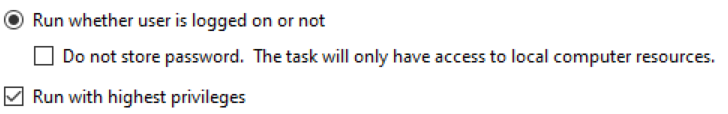

2.b: Import the xml into Task Scheduler
2.b: Modify the imported task as in the image below
2.c: Save the imported task.
