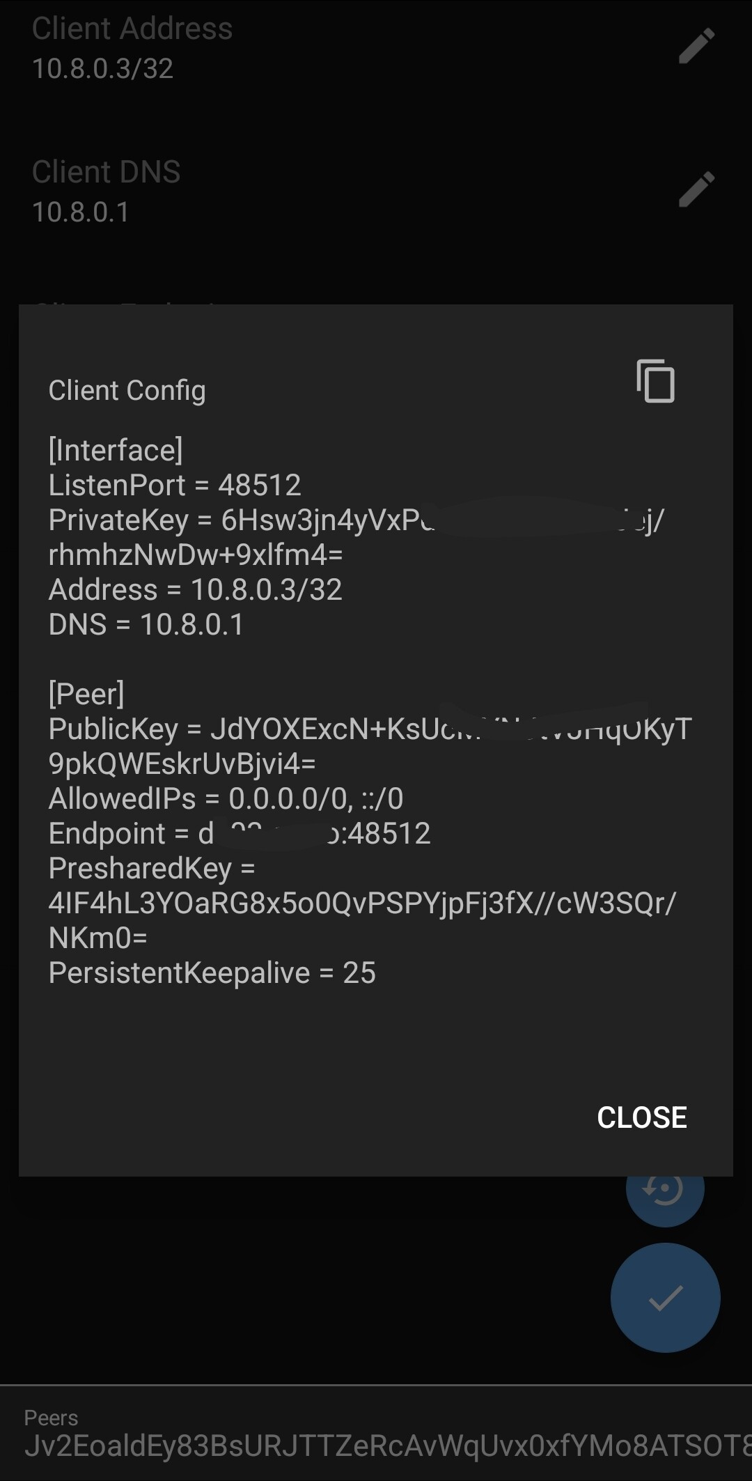

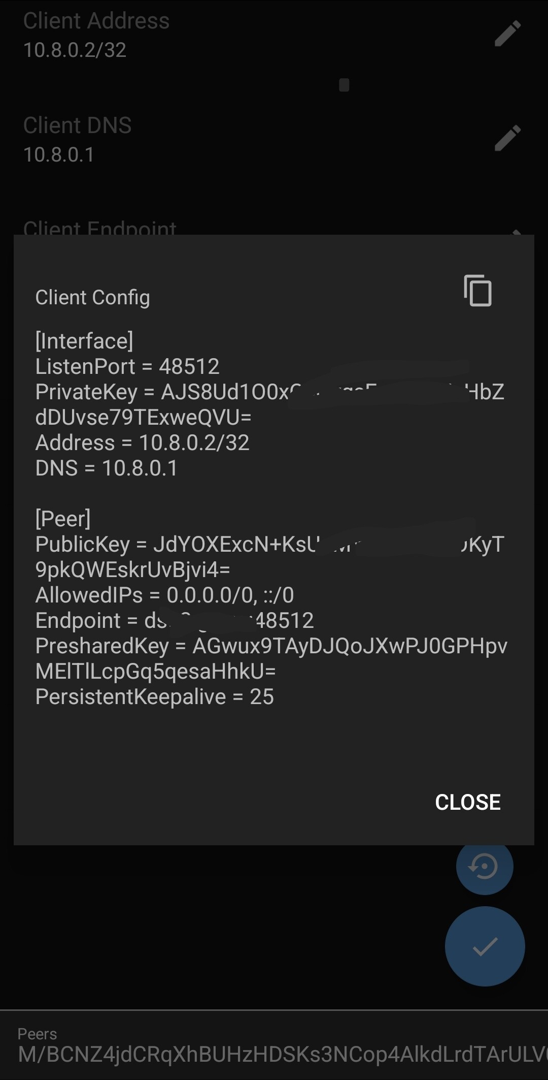

I attached config file. All sensitive data are edited. The server I’m talking about is WG_1, interface wireguard1, IP 10.8.0.1 and peers 10.8.0.2 and 10.8.0.3. All settings are attached.
