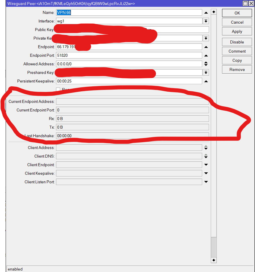

I did the config but still the mikrotik is not doing the handshaking. I can use the same wireguard configuration in other devices connected to the same network where the mikrotik gets the ip from and i can connect to the wireguard server successfully. here is the config:

The server info is not showing on the circled part as it should when the handshaking is successful but is still not showing anything
