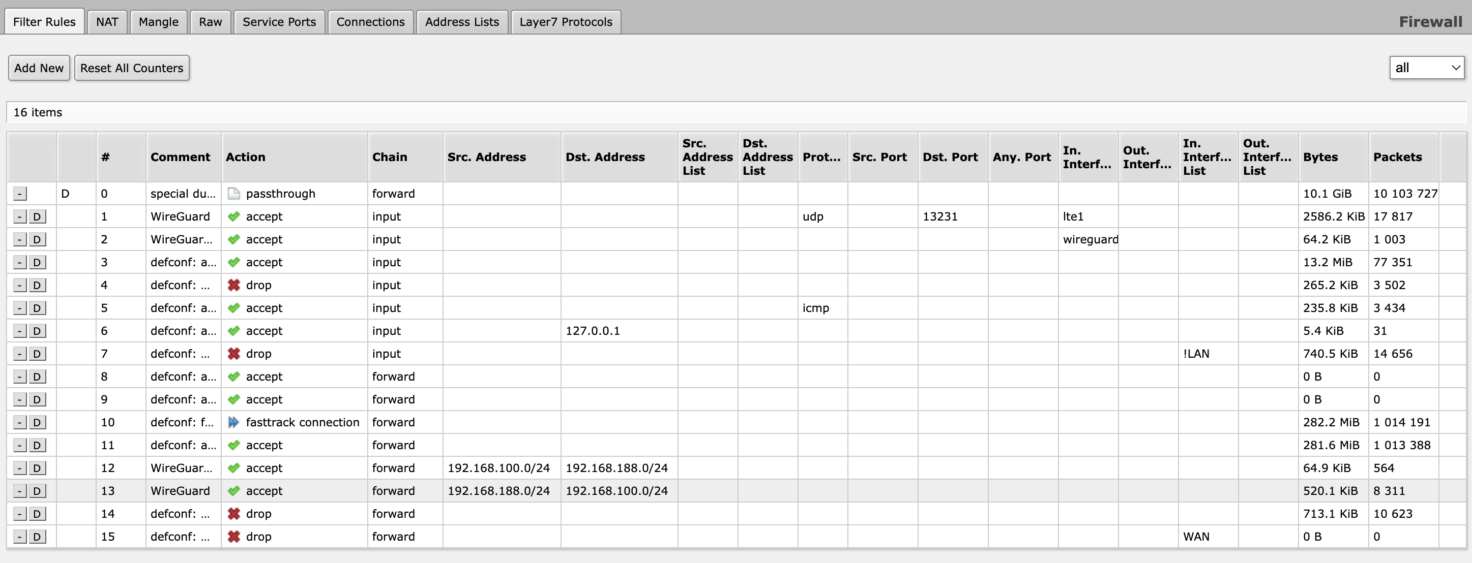

  • added additional firewall rule to give forward permission from both sub-nets to the other subnet.

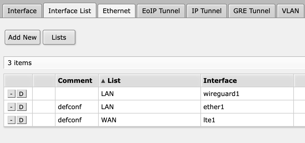

Some Pics
What is missing?

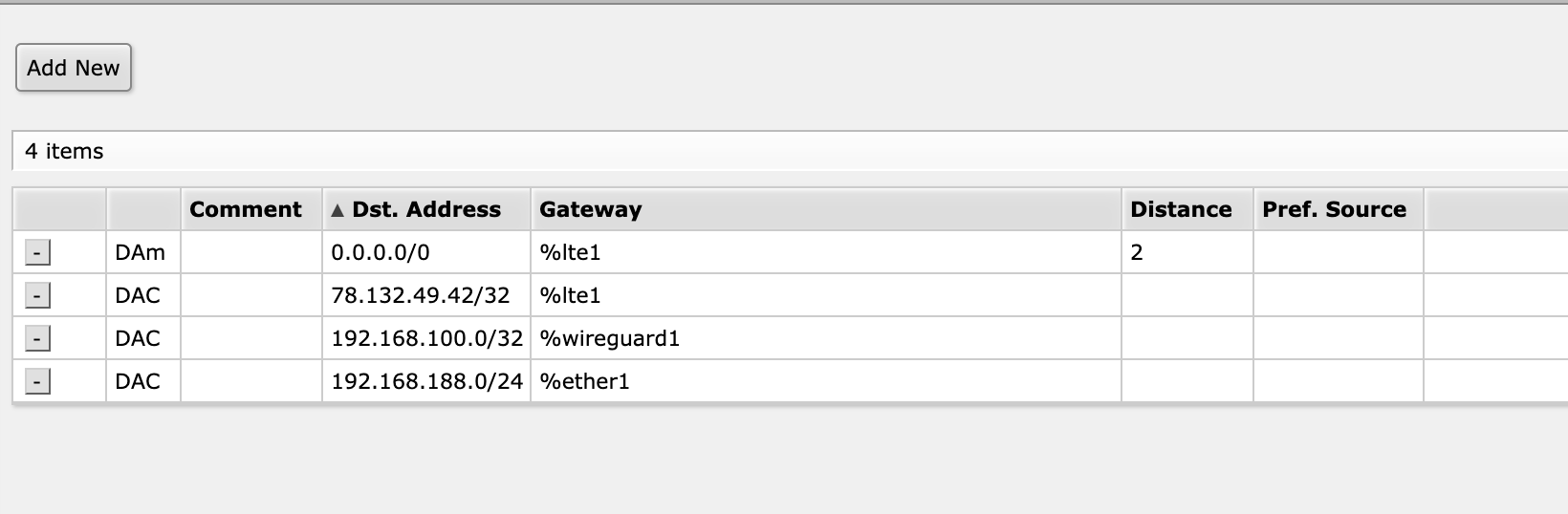

Your config export is missing the routes. Perhaps you aren’t using custom defined routes?
Also, address=192.168.100.1 for the wireguard1 interface should be address=192.168.100.1/24.
Correct, I did not add any custom route. Regarding some tutorials it was not necessary.

Nope, all you have is one remote client coming in to access your router or config (admin probably you LOL).
This rule allows the user to access the router for config purposes
add action=accept chain=input comment=“WireGuard traffic” in-interface=
wireguard1
THis rule allows the remote user to access the LAN
add action=accept chain=forward comment=“WireGuard to LAN” dst-address=
192.168.188.0/24 src-address=192.168.100.0/24
One always has to ask the question, okay so the remote client can reach the router and the LAN after exiting the tunnel, but what about the RETURN TRAFFIC.
That is where we should be concerned about routes. Remember if the subnet or user is not known to the router, NOT LOCAL, the router will drop such traffic.
Since we created an IP address for the wireguard interface, the router automatically create a route for that subnet dst-addresss=192.168.100.0/24 gwy=wireguard1
So when the remote client access the router or LAN due to the above firewall rules, and return traffic arises, the router says, I know where to send the traffic from that source address…
Now imagine if the remote client is not MAC, but another MT router with many subnets and some of those subnets are visiting your routers subnets.
Then we would need to manually make routes for those subnets so your router would know where to send the return traffic ( mainly back into the tunnel ).
