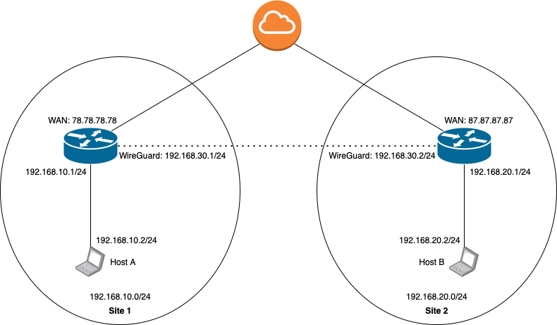

Hey, anav!
Here is a diagram that explains the situation. Both routers have a private IP associated with their WireGuard interface, as recommended.
Following this diagram:
  • Host A reaches Host B as 192.168.10.2
  • Host B reaches Host A as 192.168.30.2 (unexpected behaviour; expected behaviour is Host B reaching Host A as 192.168.20.2)

If I get rid of peer IP for WireGuard interfaces on both routers, Host B in Site 2 reaches Host A in Site 1 as the gateway of Site 2 (192.168.20.1:38452), NATed, not being behind the peer IP any longer (it is disabled, obviously). Moving the firewall rules does not change anything in this behaviour.
Changing WireGuard instances’ names and listening ports does not help either. In another setup with different routers (MikroTik again), I used different listening ports, and both routers failed in establishing the tunnel. This is why I stick to using the same ports on both routers.

There clearly is, otherwise source addresses wouldn’t change. You have only one srcnat rule:
So it must be it. And it’s possible because of this:
/interface detect-internet
set detect-interface-list=all wan-interface-list=WAN
Sob, thank you! This solved the issue. It’s weird that this featured enabled from the MikroTip mobile app could cause this behaviour…
