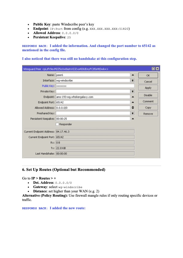

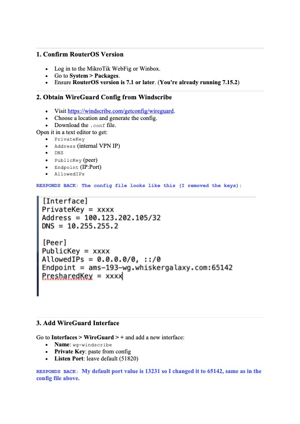

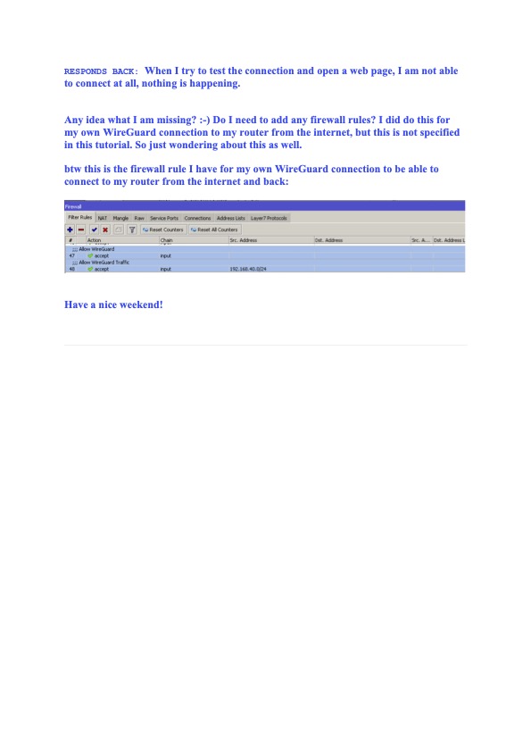

Hi, we have difficulties getting WindScribe WireGuard services correctly configured on the Mikrotik server.
Windscribe did a great service creating a manual for configuring the WindScribe WireGuard service for Mikrotik, but we are not able to get it to work.
We hope someone can have a look at the configuration and comments we supplied in the hope you can provide the last tweaks to make it work for us so we can share with the WindScribe community.
Please have a look at the correspondence below (screenshots). It is the configuration tutorial as was provided for by WindScribe and our response back to them in blue with screenshots for additional information that can assist. They told us after this response that they could not help further as this looked to them to be a specific Mikrotik configuration challenge which they did not have enough knowledge of.
Hope someone can point us to the solution. Thanks so much in advance!

  1. Take the private key given to you and when you make an interface on the MT router, use that private key to generate a public key ( that way windscribe already knows the public key you have )
  2. You can use any listening port on the construction of the interface. The peer address for the server windscribe must include the endtpoint port provided.

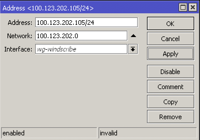

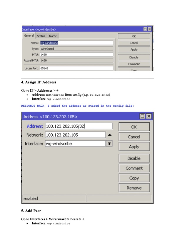

  4. When you put in address on router it should be
    add address=100.123.105/24 interface=wg-winscribe network=100.123.105.0

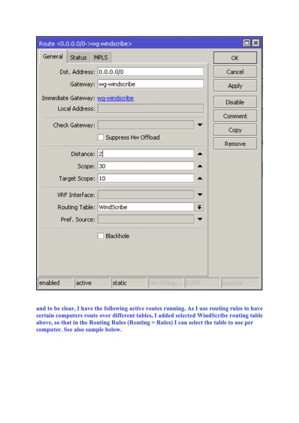

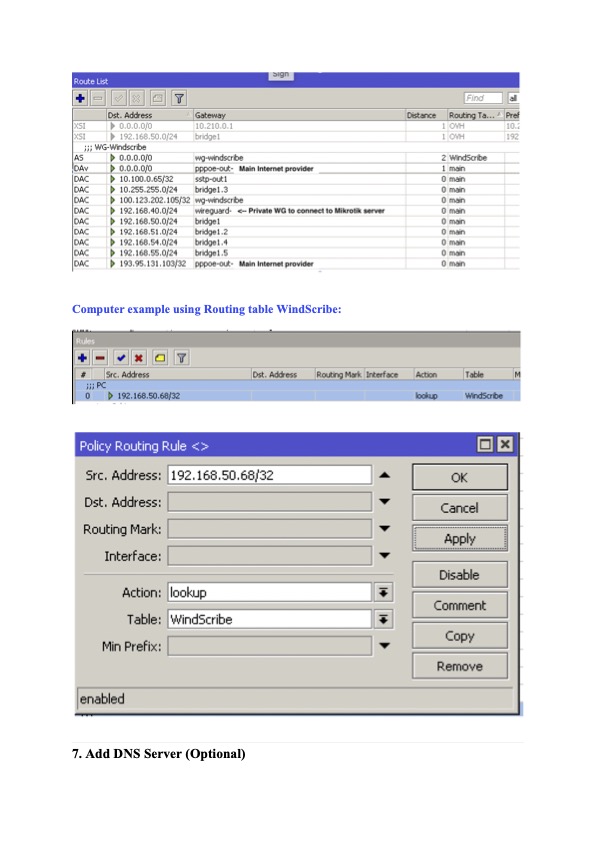

  6. It is unknown or clear what subnet(s) or user(s) require access to wireguard but it would seem only one user? 192.168.50.68 ??
    If so, then you need a table, and a route and a routing rule,

If not mistaken and if I understand you correctly for your point 1. This I have done in step 3
  1. Ok, so using 65142 would be considered fine for now.
  2. I doubled checked and its also on 0.0.0.0/0
  3. I believe you mend address 100.123.202.105/24 and network 100.123.202.0? I changed it to this.

  5. Correct, using the Rules I will select the computer that is allowed to use this connection. In this case 192.168.50.68. I did already have these rules configured.
