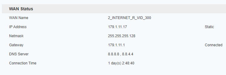

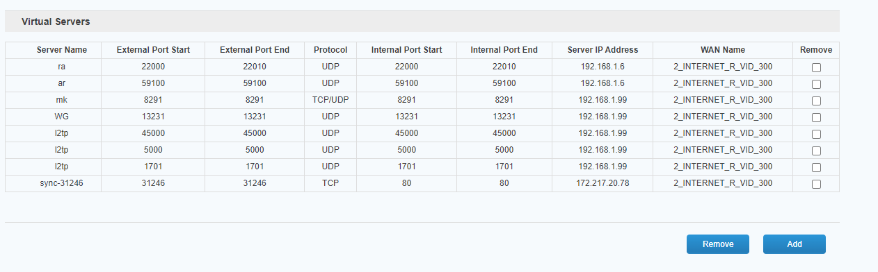

Hello, what you say is correct, I opened the port on my router that is before the mikrotik but they still do not work
Show me the port forwarding rule on the upstream router and you have confirmed the upstream router gets a public IP??
Look, the port is now open, and you also see the public IP offered by the provider.
This article shows a successful WG config with double NAT. Not ideal, but I ran that way for about a year before I was able to replace the border router with an ax³ and move WG service to it.
More concerning is the port forwarding of the default port for winbox.
Are you actually accessing the router externally using the default winbox port???
It would appear yes, you have the port forwarding setup appropriately

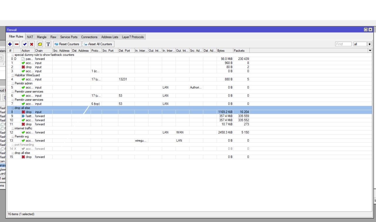

Look, I made the corrections in the mikrotik but it still doesn’t work, the amount of RX packets that come out of the client is very low and there is no internet, I have a question, is rule number 8 well located there or do I have to lower it all the way down?
configanav.rsc (4.6 KB)
It’s as far down as it can get already. Rules apply within a given chain, so with no other “input” chain rules after it, that one is at the end already. Pushing it further down in the list shown by WinBox will do zilch.
