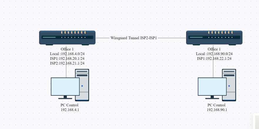

I have 2 offices:
First office have 2 isp( isp1 isp2)
Second have 1 isp (isp3)
Configured wireguard between isp2-isp3 cause isp1 has no connection with isp3.On office 1 all traffic is properly marked for dualwan. Got this error wireguard1 Handshake for peer did not complete after 5 seconds, cause in connection is to isp2 but out is from isp1(main route). What should i do?

Network Diagramm

Am I understanding your settings correctly?
  1. Office 1 has two internet connections. They are configured as a primary and a backup. Office 2 has one internet connection.
  2. The main internet connection in Office 1 is not, for some reason, able to establish a VPN connection to Office 2.
  3. You are trying to set up a VPN connection between the backup connection of Office 1 and Office 2.
As far as I understand, nothing works for you, because the packets leave through the main connection. And it is expected that they will leave through the backup channel. Therefore, I would like to look at the rules by which you provide switching between the main and backup channels in Office 1.
And for BOTH devices!
yes correctly no switching only distance in routes 1 for main 2 for backup
