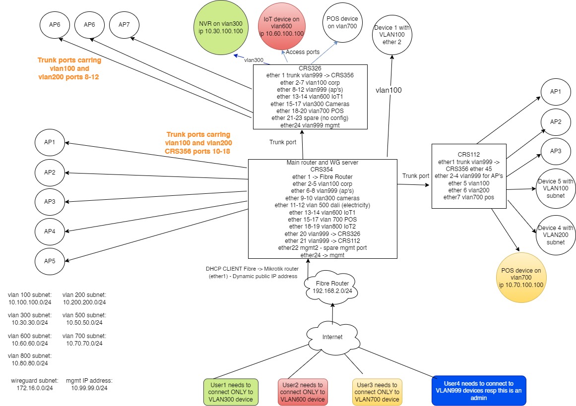

Can you make an overview (diagram) of all devices involved?
Hi erlinden, tx for your answer. Here is a diagram of my config.
I hope, I’ve made it understandable.

No…
/interface wireguard peers
add allowed-address= wireguardIP-X/32 interface=wg1 public-key=“public-key1” comment=Roadwarrior1
add allowed-address= wireguardIP-Y/32 interface=wg1 public-key=“public-key2” comment=Roadwarrior2
add allowed-address= wireguardIP-Z/32 interface=wg1 public-key=“public-key3” comment=Roadwarrior3
add allowed-address= wireguardIP-A/32 interface=wg1 public-key=“public-key4” comment=admin
/interface list members
add interface=wireguard1 list=LAN
add input chain action=accept in-interface=wireguard1 src-address=wireguardIP-A/32
add chain=forward action=accept in-interface=wireguard1 src-address=wireguardIP-X/32 dst-address=192.168.100.0/24 comment=“RW1 to vlan100”
add chain=forward action=accept in-interface=wireguard1 src-address=wireguardIP-Y/32 dst-address=192.168.200.0/24 comment=“RW2 to vlan200”
add chain=forward action=accept in-interface=wireguard1 src-address=wireguardIP-Z/32 dst-address=192.168.300.0/24 comment=“RW2 to vlan300”
add chain=forward action=accept in-interface=wireguard1 src-address=wireguardIP-A/32 out-interface-list=LAN comment=“admin access to all vlans”
add chain=forward action=drop comment=“drop all else”

Hi anav,
so here is the clarification.
I’ve updated the diagram a post above with more information’s so pls check the new diagram picture.
.Mikrotik router is connected as dhcp-client at ether1 port with 5G router given by internet provider and its public IP address is dynamic
.vlan999 is my mgmt subnet given by mikrotik
.i have dhcp-client enabled to the internet router
.pls ignore pppoe connection as the config is taken from my eve-ng lab. There will be no pppoe connectivity but only ether1 dhcp-client
At the end of ether2, 3, 4 will be some devices like.. vlan100 pc’s, vlan200 camera surveillance, vlan300 smart home. There will be vlan400, 500 for different other devices and services like dali light control and so on. The vlan connectivity is already up and running correctly.

Its not apparent to me how you send two vlans through an access port to dumb devices…
The diagram does not show smart switches accepting the vlans so its either correct or the config wrong or the diagram is incorrect and the config is okay.
i’ve updated the diagram again.

Finally the diagram is starting to make sense LOL.
Will relook at the config.
  1. Remove pvid on actual bridge itself.
  2. Add interface list of WAN
  3. SInce you fail to note which ports are going to your two switches I will assume its this way.
    ETHER1 to ISP
    ETHER2 to switch Building1
    ETHER3 to dumb device expecting untagged vlan300
    ETHER4 to switch Building2
    ETHER5 to dumb PC on corporate LAN
    ETHER6 to dumb PC on managment VLAN
    ETHER7 NOT USED
    ETHER8 OFF bridge to configure the router and emerg access if problems with bridge.
  4. Wireguard comment is weird, what do you mean to main site ???
  5. Removed address for ether1 as this is handedl by ip dhcp client. one or the other not both!!

I have something not from the my lab but from the ‘real life’ which i would like to ask you. I have an crs354 (in the script there are only 24 port not 48 as EVE is not allowing me to have a 48 port device) which does everything from the attached diagram. As a first step, i have added CRS112 which has a trunk port from/to crs354 and as ‘extending’ the network to another part of the customers building.
Now, i have tested crs354 (surely, within EVE lab) and all ports on CRS354 are doing as they should: every port is getting the correct ip subnet. CRS112 is connected to CRS354, is getting the mgmt network (and the correct vlan999 ip address on port 2,3 and 4 - Ap1, Ap2, Ap3) but i dont get the vlans on particular ethernet ports (ether 5, ether 6, ether7 - everything can be seen in the diagram). Could you pls take a look at my scripts (both CRS354-Spine and CRS112-Leaf1) as i can not find the logical error with the vlan transport. In the diagram is also another CRS326 with exist in reality but for now, I will skip its config as is should do ‘almost the same as CRS112’. Also, have i setup WG RW’s in the correct manner on CRS354?
I am thanking you in advance for your time and effort :slight_smile:
the diagram

Ok, so you think, if i do ‘the same config’ on CRS326, with existing config of the CRS112 it should work? As.. i have never worked with the switch chip before…
Is it too much to help me out on that config for CRS112?
Sorry I have no experience with the CRS1xx series. The only thing I can tell you is the concepts are the same.
There will be a trunk port carrying all the data vlans and management vlan from CRS326 to CRS1XX.
What will change is how to setup vlans but the rest of the noise should be similar.
The best thing to do is follow the example provided, the MT Docs and watch some videos, give it a stab and post back here with the results.
It should be work documented, which is similar to CRS3xx, but slightly different. Now all CRSxxx VLAN config is way different than using bridge on the hAP/cAP/RB5009/etc for VLANs…
But if you’re testing this in EVE… it may be EVE support for a CRS1xx that’s at issue – I dunno since I’m not the expert on EVE & the CRS1xx are kinda odd in overall scheme of hardware… Is the issue happening in EVE, or in a real physical setup?
I ask since the CRS1xx things is they have the “most raw” interface for correctly setting VLAN — since everything should be done via /interface/ethernet/switch to set the physical switch chip for VLANs/etc. Your config seem to use the more generic “bridge VLAN filtering”… NOT the docs @anav links which show using “/interface ethernet switch” to configure the VLANs. So while this is different than most RouterOS devices, it is the way it’s documented to use VLAN.
Now bridge VLAN filtering should work, but I’m not sure it’s the “right way” on the CRS1xx. I don’t use them, so I’d start with the docs. e.g. it’s possible there are strange things that happen when you use bridge VLAN filtering on them, dunno. But your config is kinda permissive since it use “frame-types=allow-all” and “ingress-filtering=no”, which is add complexity here since if there were VLAN troubles elsewhere, the CRS1xx just pass them along, potentially creating loops that disable ports in RSTP…
Anyway I presume Mikrotik show the /interface ethernet switch way for some good reason. Only down/flip side of doing it the “documented way” is I’m not sure that works in EVE, since your kinda setting the switch chip directly…
https://www.youtube.com/watch?v=swXS4sO8smE&t=151s
