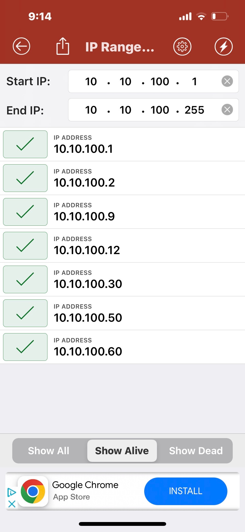

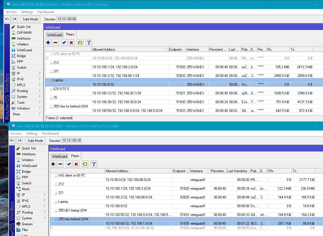

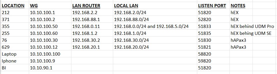

I thought I had this all working, but now I’m travelling and it’s not fully working.
I’m on my laptop and can WG into my site that I call 212. I have full VPN access to the site.
But, I thought I would be able to use the hEX at 212 (the one that I am connected to via VPN) as a relay to get access to all the other sites connected via WG to 212. This is what is not working.
Laptop: 10.10.100.201
212: 10.10.100.1
Other sites include: 10.10.100.2, 10.10.100.12, 10.10.100.50 – no access from my laptop.

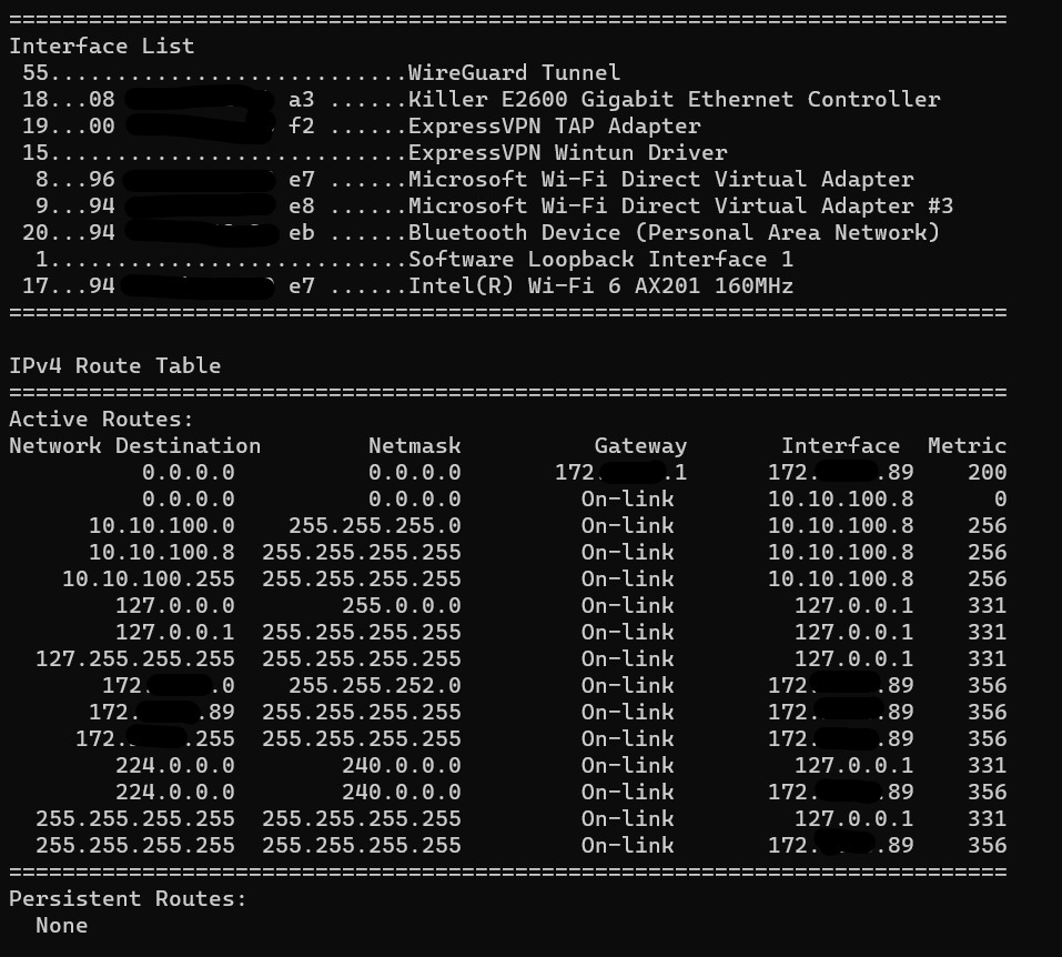

The Windows WG config I’m using to connect to 212 is:
[Interface]
PrivateKey = uI6xxxxxx=
Address = 10.10.100.201/24
DNS = 10.10.100.1
[Peer]
PublicKey = xx24Ds=
AllowedIPs = 10.10.100.0/24, 192.168.0.0/16
Endpoint = xxxxx.dyndns.org:51820

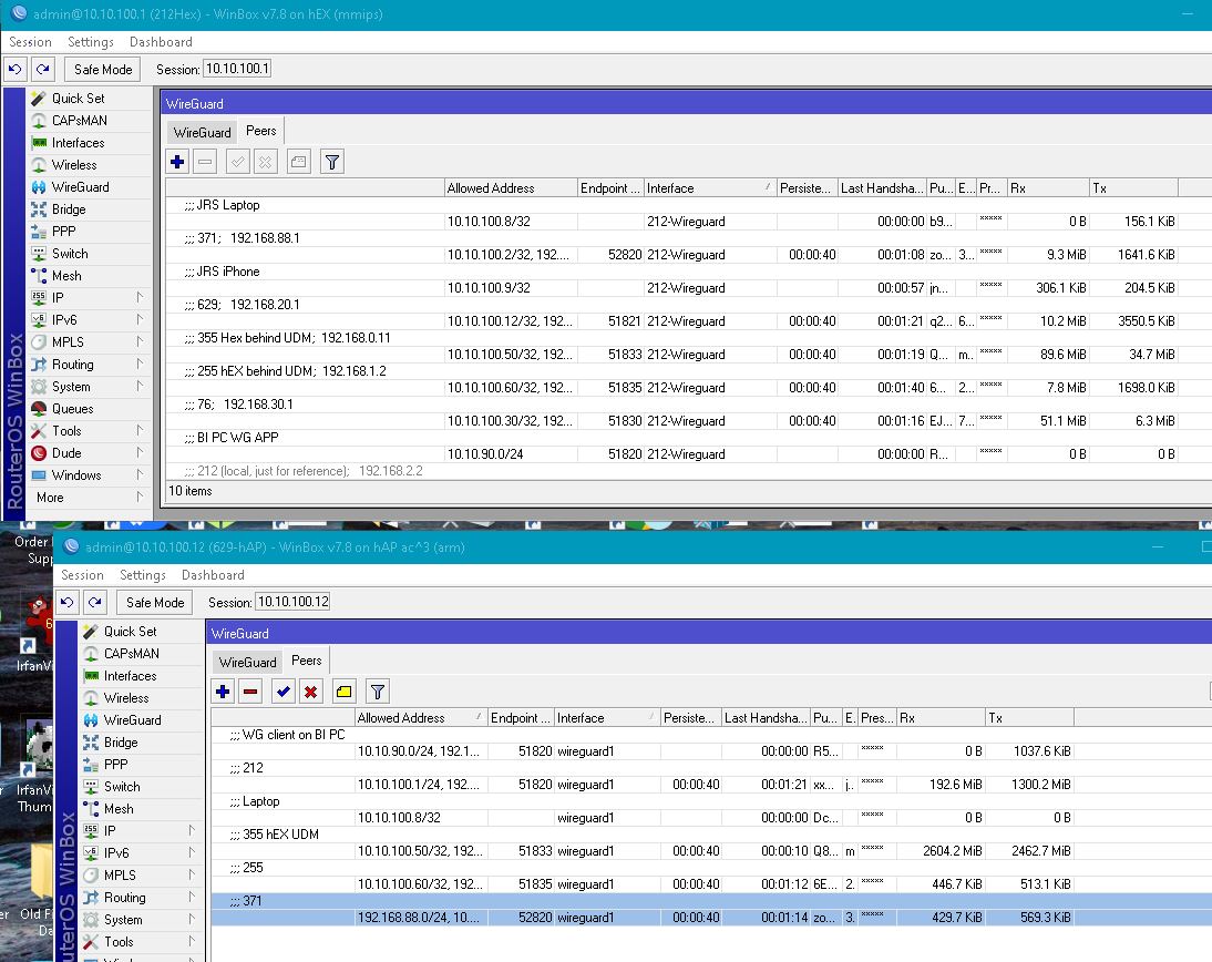

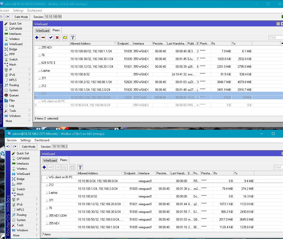

/interface wireguard peers
add allowed-address=10.10.100.8/32 comment="JRS Laptop" endpoint-port=58820 \
    interface=212-Wireguard public-key=\
    "b9ijRpJX8="
add allowed-address=10.10.100.2/32,192.168.88.0/24 comment=\
    "371;   192.168.88.1" endpoint-address=xxxxx.dyndns.org endpoint-port=52820 \
    interface=212-Wireguard persistent-keepalive=40s public-key=\
    "zoZtzU5lohI="
add allowed-address=10.10.100.9/32 comment="JRS iPhone" endpoint-port=59820 \
    "jn2xmSuBAuOb/ZBIFY="
add allowed-address=10.10.100.12/32,192.168.20.0/24 comment=\
    "629;   192.168.20.1" endpoint-address=xxxxx.dyndns.org endpoint-port=51821 \
    "q28mg9oG4CfXo="
add allowed-address=10.10.100.50/32,192.168.0.0/24,192.168.5.0/24 comment=\
    "355 Hex for behind UDM;  192.168.2.5" endpoint-address=xxxxx.dyndns.org \
    endpoint-port=51833 interface=212-Wireguard persistent-keepalive=40s \
    public-key="Q8CPxxxxxLZq3g="
add allowed-address=10.10.100.60/32,192.168.1.0/24 comment=\
    "255 hEX behind UDM;  192.168.0.11" endpoint-address=\
    xxxxx.dyndns.org endpoint-port=51835 interface=212-Wireguard \
    "6E3xxxxxMwbRc="
add allowed-address=10.10.100.30/32,192.168.30.0/24 comment=\
    "76;   192.168.30.1" endpoint-address=xxxxx.dyndns.org \
    endpoint-port=51830 interface=212-Wireguard persistent-keepalive=40s \
    public-key="EJu69xxxxxcNgUic="
add allowed-address=10.10.90.0/24 comment="BI PC WG APP" disabled=yes \
    endpoint-port=51820 interface=212-Wireguard public-key=\
    "R5SjZxxxxxjt9TV4="
add allowed-address=10.10.100.1/32,192.168.2.2/24 comment=\
    "212 (local, just for reference);   192.168.2.2" disabled=yes \
    endpoint-address=xxxxx.dyndns.org endpoint-port=51820 interface=\
    212-Wireguard public-key="xx27xxxxxop1OqXrW4Ds="
add allowed-address=10.10.100.201/32 comment="JRS Laptop 201" interface=\
    212-Wireguard public-key="Cmfwxxxxxhgntx9Aw="

HEX212: The only two things noted on 212 are below, so dont really see a show stopper here…
(1) Your laptop etc is missing persistent-keep-alive setting on the peer for 212.
(2) Why do you have keep alive set on the HEX for all the client peers that are routers except the one discussed at (2)? Its client devices which require persistent-keep-alive! on their peer setting for the hex!!
OTHER ROUTER 100.2 Found it…
(3) THE PEER SETTINGS OF CLIENT FOR WIREGUARD MUST BE SUBNET!! aka 10.10.100.0/24
Think about it…
Allowed IP is for two reasons.
a. allow traffic with destination traffic of that IP ( router matches on destination and looks for peer entry of same for outbound traffic to send to right peer)
b. allow incoming traffic with that source IP ( router filters incoming traffic to allow it to exit the tunnel ).
You had it right for your peer to be able to outbound be matched for any of the wireguard IP addresses of the other routers…so that part was good.
However the other routers would not accept (fiilter out) any wireguard IP address that was not the HEX one on the inbound.
So you cut off your own nose LOL.
I am very confused as to why your hex 210 is setup as though it was the server and not the hex212.???
Are all the wireguard clients connecting to the 212 or the 210??
210 should only have one peer and that to 212 ??
Lets say for example…
212 was the main WIREGUARD SERVER for clients A,B,C,D,E with A being 210.
I think it may be possible using the same wireguard structure for
210 to be the Wireguard SERVER For clients F,G,H,I,J for example.
all using the 10.10.100.0 subnet.
If this is the case I then on hex 210, only the peer setting for 212 would require the 10.10.100.0/24 client peer setting.
The rest of the peer settings would /32 as the 210 would be acting as server for initial handshake.
In this regard on your laptop you could connect to 212 get routed over to 210 and actually access router at J.
All to say need more clarity on your setup to get the proper context.
SO COME CLEAN on what the heck you are doing with 210 ???
other stuff
note wny is client BI PC given an allowed IP of 10.10.90.0/24 whereas the rest are /32 ???
why two rules that dont really do anything productive in terms of indicating what particular traffic flow is permitted.
The second rule is nonsensical and will never be seen anyway!
add action=accept chain=forward comment=“Allow wireguard to subnet”
in-interface=wireguard1
add action=accept chain=forward in-interface=wireguard1 protocol=udp
  1. The reason I took out the persistent is because I was tired of seeing the repeating packets from 127.0.0.1 that Wireguard generates when there is a peer with a persistent time set and no endpoint.
  2. I have been trying, unsuccessfully, for hours to get the relay to work.
I’ve tried 10.10.100.0/24, 10.10.100./24 in the peer configs.
Maybe there is a routing interaction between the multiple peers?
For example, if multiple peers have 10.10.100.0/24 in their allowed-ips, does that confuse the routing?
The terminology is challenging also: My understanding is the WG has Servers and Peers. And, there is only a very subtle difference between Server and Peer. Possibly that difference being which device initiates the connection.
Where do “clients” fit in?
Regardless, it’s frustrating.
To be clear:
212hEX should be the relay server (the WG that everything connects to).
201 is my laptop
10.10.100.30 is a peer of 212 hex
10.10.100.2 is a peer of 212hex
If 212 is the only main server for handshakes, I pointed out why its not working and the fixes.
Ensure you do them and post again for any additional refinements…
Im sorry but i don’t understand your instructions.
Mind the quotes, the second one comes before the first but you need the answer on the first before we move to the other one.
There is no confusion: ONLY peers on Wireguard.
For simplicity reason most refer to SERVER (the “hub” or relay) and CLIENTS (the “spokes”)
The difference is only defined by which peer acts as relay for all the others. Usually that’s the one having a fixed IP (or dynamic IP using DDNS).
Not for the clients since they all need to go to the server first (aka hub or relay, if you want). If however you do not want peers to communicate between each other, only use ip address of the “server” as allowed address.
On the “server” you need to specify the endpoint address of the peer as allowed address (and other subnets, if applicable).
At the end of the spokes :sunglasses:
And you really should keep persistent keep-alive active on the ‘clients’.
Not on ‘the server’ (it knows where it is since it has a reachable IP)
I got it working.
I am well aware that people far smarter and with far greater expertise have cumulatively written millions of words describing how this works and how to set it up. But, if you’re dense like me, perhaps this will help.
Some clarification (or added confusion) for the future frustrated among us:
Wireguard uses only “peers.” No “servers,” “clients,” “hubs,” “spokes,” or “relays.”
However, using these terms (consistently, and after understanding the strictly ‘peer’ nature of WG) can be helpful when planning, designing and implementing WG.
For example, I have 6 locations that are connected with WG tunnels. In it’s simplest form, each location is a peer to 5 other locations. If one location goes down or suffers from my inquisitiveness of ‘seeing what this config change will do’ then only that one location suffers the fate (unavailability). Similarly, if I play with a peer setting at that location (as opposed to the WG interface setting), then the connection between that location and the location of the peer setting I played with suffers the consequences.
At each location, WG is running on a Mikrotik device. I am intentionally not calling it a server to keep with the peer-only terminology.
I will call the WG running on the MT device the WG Interface. That way, we can describe the configuration of, for example, the WG Interface at location X. Or, we can describe the peers settings at location X that connect to peer Y.

I totally suck at drawing. How about this:
WRT 0.0.0.0/0 – the WG app adds a second default route to Windows and I’m wondering if that creates a situation where some packets are routed out the WG tunnel and some not.
The keepalive will keep the connection alive, as its name indicates.
Typically this is not needed on the peer having the static IP (or DDNS with some scripting).
For all other peers it is advised to have it set (unless you’re fine with disruptions when their local IP changes for some reason, typically the case with cell phones moving around)
I seem to miss the part with allowed addresses in your table ?
That route for 0.0.0.0 has a metric of 0 so it should get priority. But where does 10.10.100.8 come from ? It has not been mentioned before ?
I, too, am puzzled by the 0 metric not working.
I think Windows has a problem with 2 default (0.0.0.0/0) routes, even with different metrics.

I think I got it working. By “working” I mean the following:
  1. All 6 WG devices have a WG interface and all 5 peers configured in it’s “Peers” tab, so there is a tunnel between any 2 locations (I believe there are 15 combinations of 2 in a group of 6)
  2. Each of the 6 WG devices have a single IP address associated with it in the 10.10.100.x/32 single-ip-block
  3. WG at 212 location is my designated “server” or “hub”
  4. Laptop and iphone connect via their WG apps to the 212 location
  5. Tunnels between 212 and other 5 locations pass traffic on the LAN subnets (192.168.x.x) of all of each other’s locations
  6. It seems the key to getting this to work is to configure the 212 peer entry in the other 5 WG devices to include 212’s 10.10.100.1 address with a /24. All other peers have their 10.10.100.x IP addresses with a /32.
It is clear to me that using words alone makes communicating about how to configure WG extremely difficult I am including screen shots of the config. I know an exported config is generally far more useful (and I’d be happy to post them), but I think screen shots communicate things easily.
Peer 10.10.100.1 is 212.

Finally, ping confirmation on the iphone:
I’m not even trying any longer to route all laptop/iphone traffic through the tunnel.
So where are my errors?
