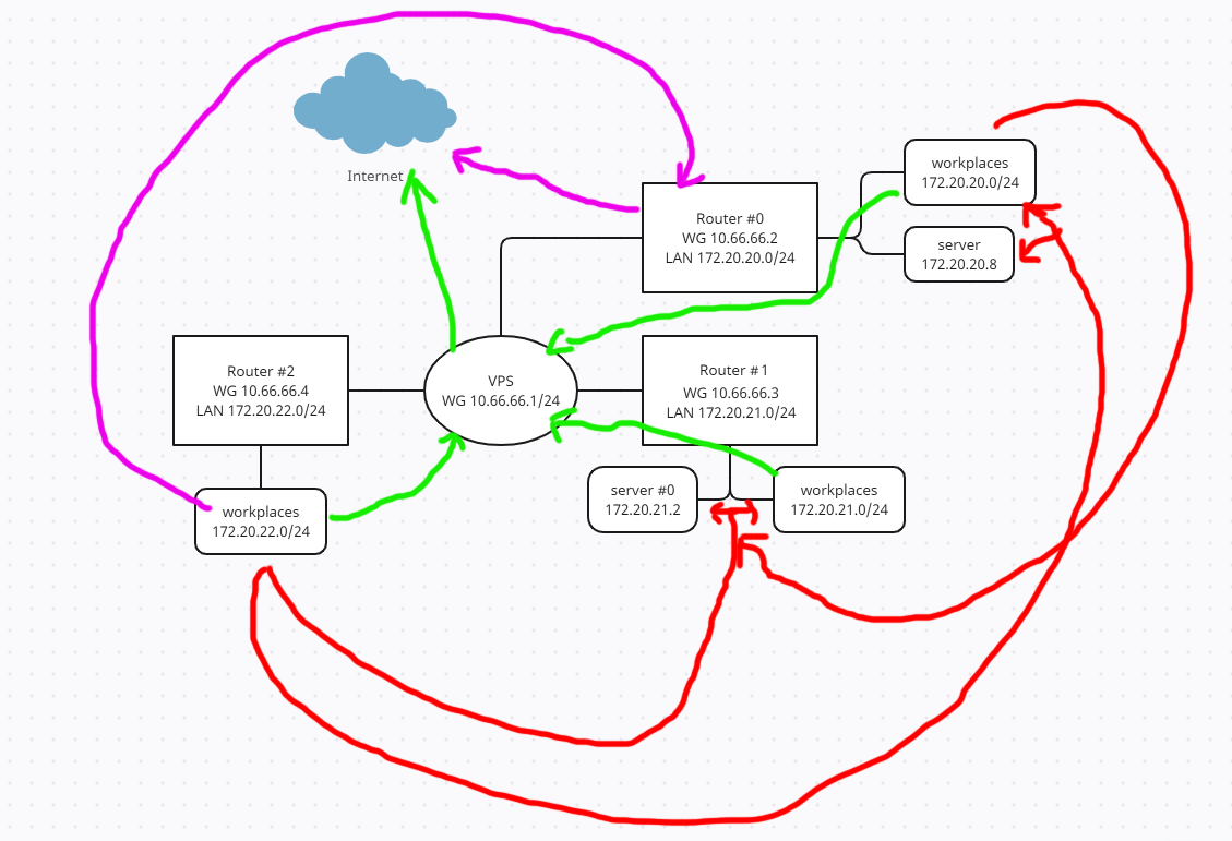

Hello! I started with Mikrotik not so long ago and still have a poor understanding of routes and other things. Please help me create a network configuration like this:
There are 3 networks and a server with Wireguard installed. I need:
  • Users from the network 172.20.21.0/24 have access to the server and network 172.20.20.0/24
  • Users from the network 172.20.20.0/24 have access to the server and network 172.20.21.0/24
  • Users from the 172.20.22.0/24 network can access servers and networks on both 172.20.20.0/24 and 172.20.21.0/24
Additional Internet access (by routing marks):
  • Users from network 172.20.20.0/24 via VPS
  • Users from network 172.20.21.0/24 via VPS
  • Users from network 172.20.22.0/24 via router 0 (priority 1) and via VPS (priority 2)

Since I dont know what VPS is the diagram makes no sense to me.
Why do all routers have a hard connection to this magical VPS
What is a square box not named a router.
It appears you have two different devices wired together with connections to the internet.
Nothing makes sense to me.;
Sorry, I fixed: square box is Router #1
VPS: Virtual Private Server, external web-server with white IP address, where I run WG and my branches (2/3 with grey IPs) connected to. And it is not a hard connections, it thorugh the internet, sorry for my diagram
I still dont see which routers have internet access directly it appears at the moment only Router 0 ???
Is VPS the only wireguard device? If not would need config of all MT devices (full)

I made a simpler diagram. All routers are connected to the internet. All routers are connected to the VPS using WireGuard over the internet.
The VPS is a Debian based server with Wireguard software (not a ROS based device). I pointed the circle as the gate that should provide Internet access (in green or purple direction)
