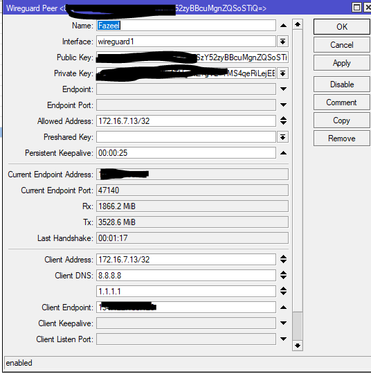

I have pcc load balance.
So I want when ISP1 goes down user can connect to ISP 2
So I can also add the IP address of WAN-1 in the client Endpoint in Peer?
Regards
