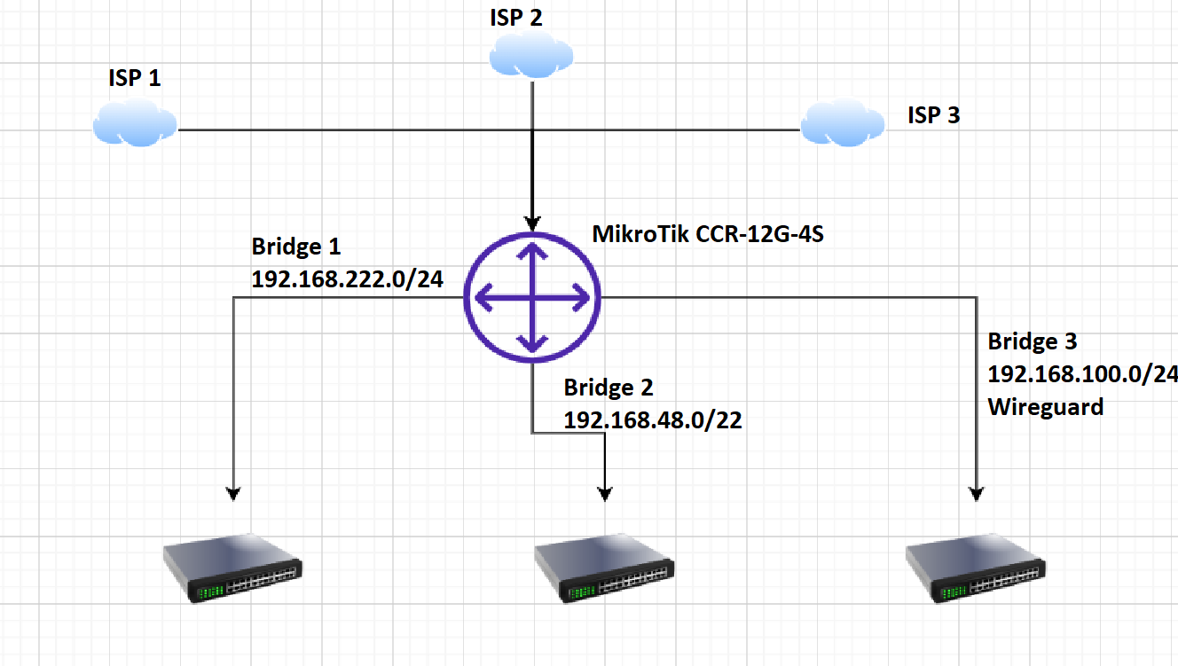

Mangle rules are for Wireguard tunnel to have internet from a specific ISP. We have 3 different ISPs going through 3 different subnets.
The in-interface=wireguard-SKA was to specify from which interface the connection was established. Since there’s no firewall to block ports yet, this rules didn’t have any impact. But I could see the traffic flow after I connect Wiregurad.

Without a network diagram and a complete config, not more one can assist with.
Too many details hidden
/export file=anynameyouwish (minus router serial number and any public WANIP info).

You have one Wireguard client correct?
(1) THis is WRONG, as stated above,
add action=accept chain=input comment=“allow WireGuard” dst-port=13231
in-interface**=wireguard-SKA** protocol=udp
For the last time, the initial handshake comes via the ISP connection. You have some options,
You know the specific WANIP ( users using domain name )
in-interface=ETHERX protocol=udp
or you dont or from a catchall perspective.
in-interface-list=WAN protocol=udp
(2) It would seem by your sourcenat rules that your 3 ISPs give FIXED/STATIC IPs . Assuming you are getting static public IPs.
Just to note if you are actually getting private IPs, the ISP is using modem/routers, and you will have to port forward the wireguard listening port from the correct router to the MT.
  • I had 4 wireguard peers before the upgradation, and now only one for testing versions.
  • I’ve 3 ISPs which are giving me static public IPs. I don’t use the domain name as many users do, I use direct fixed public IP and mentioned port 132131 for wireguard.
  • Also to mention, all are working just fine whenever I’m using the 7.3.1 version. I’ve tried all versions after this, i.e. 7.4.1, 7.5 … etc., but whenever I upgrade the firmware from 7.3.1, wireguard doesn’t work. I’ve reported it to MikroTik Support as well. Let’s see their response as well.
At this point it doesn’t matter why it worked for you on older versions, as you where told multiple times, you need to allow UDP port on WAN interface or wireguard wont work no matter what, thats the same response you will get from Mikrotik support.
